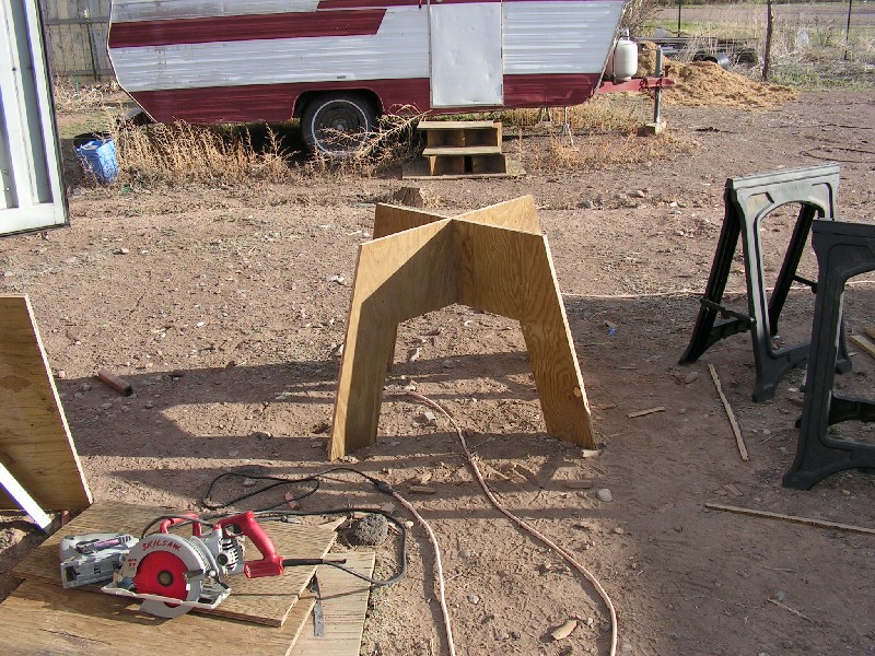

The snow finally melted, the mud dried up, finally feels like spring. Couldn't stand it anymore, time to do something outside.
I didn't have any good ply, nor the $$$ to get some, so this prototype is made out of salvaged pressure treated 3/4 ply "liberated" (yes, I did ask) from a construction site. Unfortunately it spent the winter out in the weather and is in less than stellar condition, but I'm going to forge ahead anyway. This one will definitely be painted. Maybe the Mrs. will help me with some kind of faux finish.
Anyway, to the pics (YAY!!!) Please ignore the "rustic" nature of my "workshop." (Lots of work to do before summer gets into full swing)
Started by cutting out the legs ...

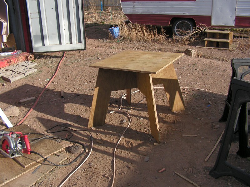

Then cut out the top ...

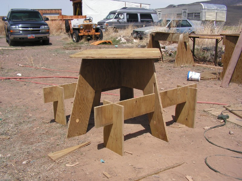

Seat supports ...

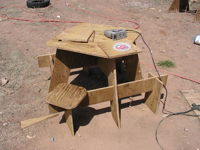

And finally the seats ... (the first one anyway)
... more to come. Sanding, rounding over edges, dowel pins, finish, etc.
Initial thoughts ... not as comfortable as the big table (can't stretch out legs), but would be ideal for a board game or dinner with people that you like (the space available is reminiscent of sitting at a card table). It doesn't feel as sturdy as the big table either, but that may be a factor of the marginal materials that I'm using and the not-quite-perfectly-flat floor.

Cool, I love it when people build things I've been eyeing. :lol: Can you connect the ends of the seats together somehow? I bet that would make it a lot sturdier.

bdosborn wrote:Cool, I love it when people build things I've been eyeing. :lol: Can you connect the ends of the seats together somehow? I bet that would make it a lot sturdier.
One of the requirements I have set for my tables is that it is possible to sit down without swinging your feet/legs over any obstacle. This is to assist those who are less agile than your average camper. Yes it would make it a lot sturdier, however, I don't think that it is necessary.
My comments in that previous post were in comparison to the large table. The large table just feels a bit more solid to me.

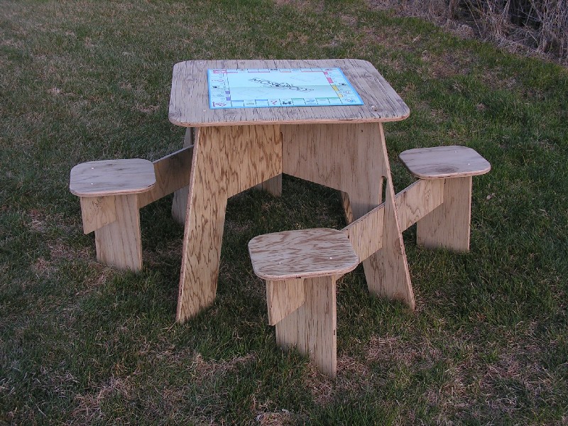

Here it is, ready for finishing ...
Monopoly board to help show scale ...
It turned out nice despite the harsh ply that I used (it was free, but notice the weather checks!). Overall, I'm pleased with the results, only one snafu on the plans (see above post). A nice layer of paint (trying to talk the Mrs. into helping with a faux finish) and it will be ready for use.
FYI -- I have it stored in a space that is only 30" x 48" x 3 3/4", assuming that your ply is flat (this one has a stack of dutch ovens on it trying to "retrain" flat.) Also, if you can get the 30" square top through your door, I'm confident that you will be able to put this on (or under) your bed to haul it to your destination.
Still welcoming comments/suggestions and I would LOVE to see some pictures of other TearTables that have been built.

Postby Dragonryder » Mon Apr 19, 2010 6:10 am
Well done!!! :thumbsup: :thumbsup: :applause: That's what I love about this site. The wonderful creativity that is displayed. By the way, I like the rustic look. My camper shows the rough wood under the paint. Looks fine to me. :)
