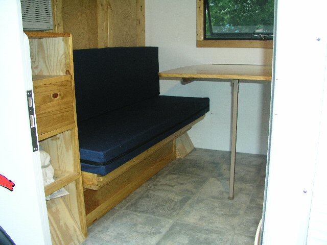

Here's the one with the table down...

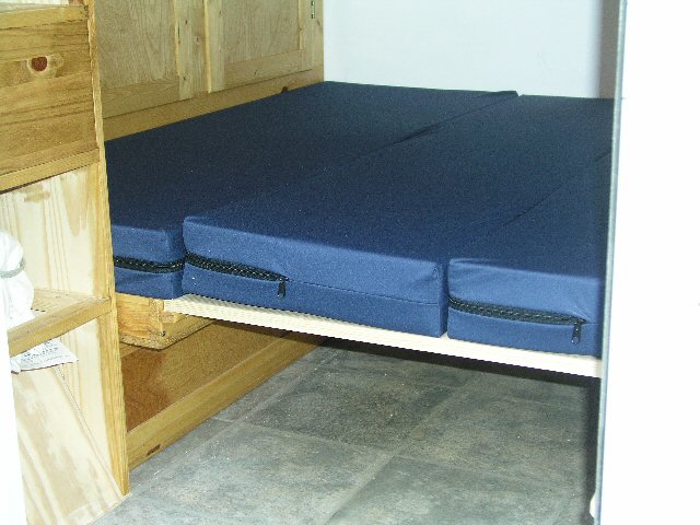

And here's the one with the table up!
And you already know, that's a queen sized bed in there that we are sleeping on!!! :shock:
Postby Shrug53 » Fri Jun 18, 2004 8:10 pm
Many thanks. Does that leg just fold up? when you lower it to the lip? How is it attached to the wall there? Some kind of latch or rail or something?

Postby mikeschn » Fri Jun 18, 2004 8:14 pm
Yes the leg just folds up. I bought it at the local RV dealership. I think it was around $15.
And it attaches to the wall with a fancy piece of aluminum that fits over a channel. I'll see if I can get a picture of that for you tomorrow.

Postby mikeschn » Fri Jun 18, 2004 8:26 pm
You may not have seen it, cause I have it covered with cushions, but since the table is not as wide as the bed, I have 3 additional boards that I set on that lip to bring the width of the wood out to 5'.
