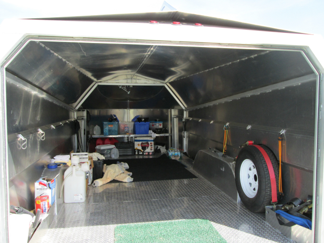

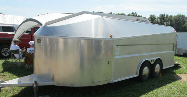

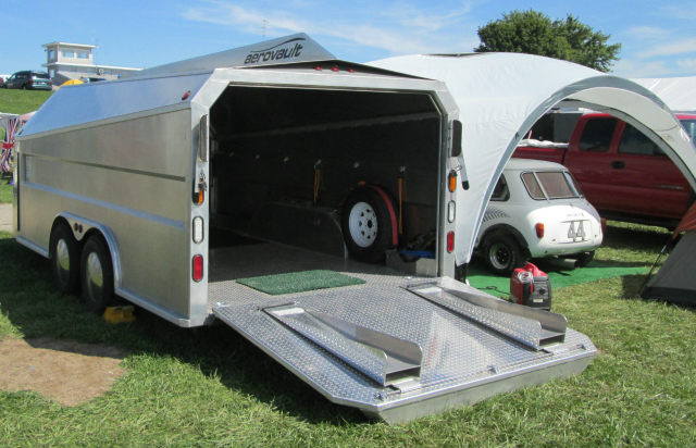

Postby alaska teardrop » Fri Sep 07, 2012 2:42 pm
    Hi Ron,
    Ran across this Aerovault Trailer designed by Pete Brock the other day at the races.
    The construction & materials are simular to welded boats. :designing:
    :peace: Fred

Postby KCStudly » Fri Sep 07, 2012 4:17 pm
That's pretty cool. Here're a couple more links.
http://www.bre2.net/pdfs/bre2_aerovault_brochure_2011_11_27.pdf?phpMyAdmin=k9QIsjCI-UCmbjFU6X2usBJKjz3
http://blog.roadandtrack.com/tags/aerovault-trailer/
Gulp, just $24k before options. Let's see, how many should I add to my on-line shopping cart? :thinking:

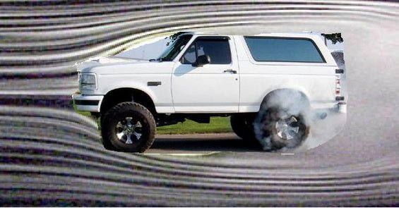

Postby Ron Dickey » Sat Sep 08, 2012 12:53 am
a modern Pickup might do this
and the height of the puller might effect the trailer from wind coming from under the puller.
and a pickup truck youtube offers a s10
http://www.youtube.com/watch?v=rGHnCfJ- ... r_embedded

Postby Ron Dickey » Sat Sep 08, 2012 12:57 am
http://www.youtube.com/watch?v=4HLBy-ui ... re=related
Truck and trailer kind of a teardrop. it is really a "Airflow over of my 2008 Mazda Tribute and 2009 Forest River r-pod. The silhouette was created from a picture of my truck/trailer parked on a flat roadway."

Postby S. Heisley » Sat Sep 08, 2012 4:29 pm
The floor plan of that Aerovault Trailer shows considerable thought and promise. In particular, it shows that, even though the majority of the trailer width is 80", thanks to the curves, the front area is the width of many tow vehicles, and then it graduates out, to get the best benefit of air flow that it can. :thumbsup:
http://www.bre2.net/pdfs/bre2_aerovault ... X2usBJKjz3
