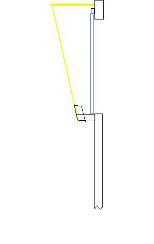

some sketches to help anyone interested understand the details
view cut in half
116351
view from inside looking out
116352
outside looking down and in
116353
outside looking in: make sure the inner lip is higher than the outer one, your drain holes may get plugged, but the gutter will still drain outward that way.
116354
top view
116355
lying under the window frame
116356

My question would be why have an outer lip at the bottom of the aperture? Eliminating this means that the inner lip can be smaller and there is no need to drill drain holes as the bottom of the window is open to the outside. The major advantage is that is is then much easier to seal the bottom ledge and to keep it clean.
There is a security problem in that it is possible to lift the glazing up when the window in the closed position (though this is true with any Wiley window) but I overcame this by adding a stop bead at the top.
Michael

I believe the window will have a better water and dust seal by having an inch overlap all the way around the glass, but I could be wrong. for my design the bottom lip is needed for the screen to be secured, around here you will get eaten alive without them. Back home in Maine the black flies area a serious issue, around here misquitos.
I didn't draw a screen into it just to keep it simple.
I believe you plan to have a screen on the outside, in that case a lower lip may not be needed. .
that is the beauty of it, there is no wrong way, as long as it does what YOU want it to. :thumbsup:

The old yacht window technique was to move those drain holes down by half a diameter and then cut a tapering groove (gutter) across the inside bottom piece to line up with the hole, so that water would drain fully out of the recess. Water collecting in there is not good for the long term rot avoidance.

thanks angib! :thumbsup:

KennethW Could you build a mock up of what you are talking about? That will help. I did not understand the Wiley window until Josh put the drawings of the angle of looking into the window corner or as he said the cutaway. That made the mud perfectly clear. The reason I want the little ledge at the bottom of the window is to be able to "seal the window up against the frame to keep dust from getting in and so that "no see ums" and mosquitoes will have a harder time getting in, If cleverly done I can put a little screen over the drain holes too. If the window is thinner plexie-poly it will also keep it from bending out at the bottom.
Thanks for the drawings.
Mary C. :lady:
