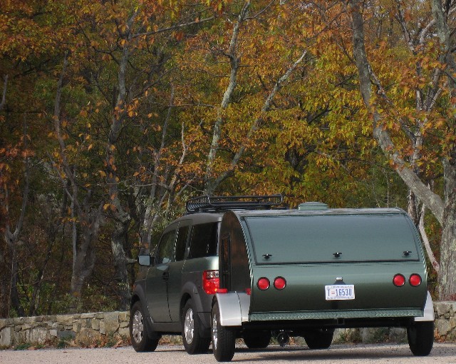

Postby hiker chick » Sat Apr 05, 2008 6:06 pm
That's sharp looking - congrats!!
I bought a 6'-wide Little Guy last fall. Camped just a little before winter set in. Will be back in the mountains in a month or so. Wrote about it and posted several pics in this thread.
http://tnttt.com/viewtopic.php?t=20021
Will be posting a lot more when we're back out camping this spring.
So far I don't have any complaints.
