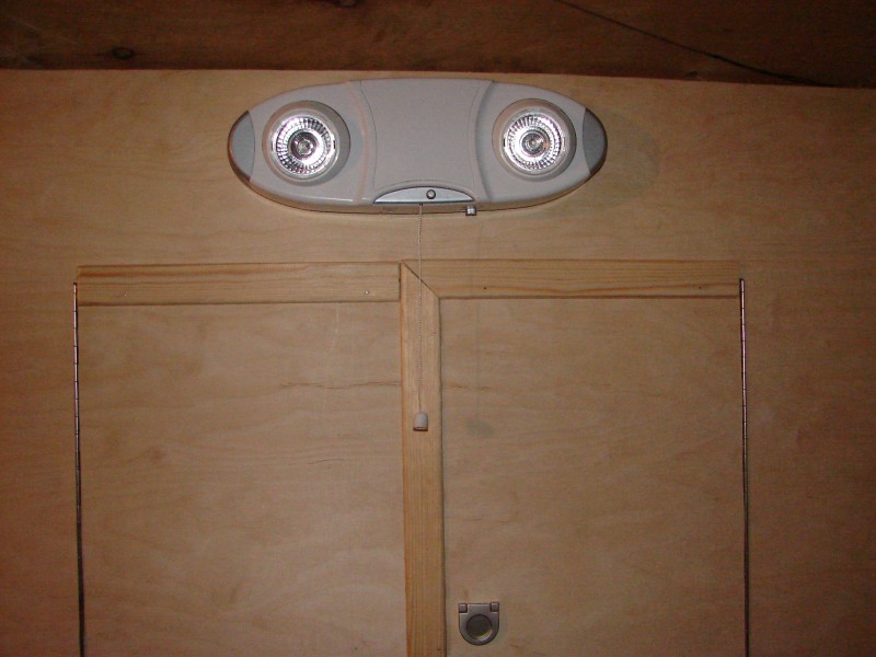

Postby mikeschn » Wed Jan 04, 2006 3:43 pm
Here's some food for thought... given the high prices of some light fixtures I've seen...
this one is pretty affordable...
You buy a regular closet light...
You pull out the bulbs and get some 12v bulbs...
Hardwire it into your circuit, and voila... 1 affordable light fixture...

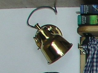

Postby MeelisV » Mon Jan 16, 2006 3:39 am
maybe its not unique but im useing it
