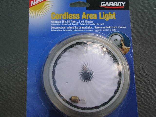

The final prize is will be determined this week, but will include 2 Closet lights, which run off AA batteries, or can be converted into 12V. The lights look like this…
