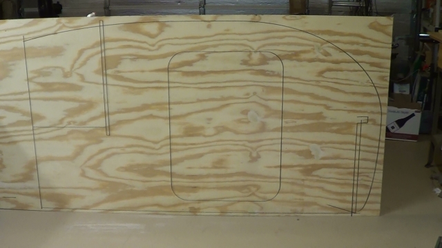

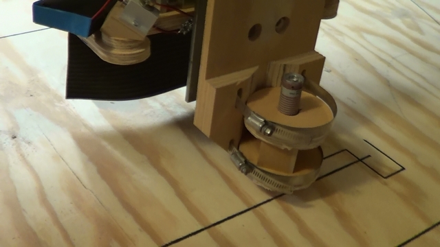

Here's a case where when your favorite tool is a hammer, everything looks like a nail. When your favorite tool is a CNC machine, ...
I'm using the CNC to trace the outline onto a piece of wall plywood.
First, you need something to hold s writing implement, like a felt tip marker. Parts made on CNC, of course. It fits in the same holder I use for the router motor.
Then you create g-code from your CAD drawing and draw the outlines.
The finished product:

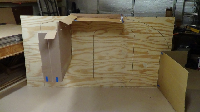

Finally, tape & staple cardboard, so you can get the feel of what your interior is like.
I will be shortening the rear cabinets, so I can get under there and tuck in the sheets.

Postby GuitarPhotog » Mon Nov 25, 2013 4:30 pm
Prototyping with cardboard like that can save lots of problems downstream.
You are correct in wanting to change the rear cabinets. I hate having to go "head down" under mine to tuck in the sheet at the foot of the bed.

Re: CNC Design
Postby halfdome, Danny » Mon Nov 25, 2013 6:28 pm
If you order a two piece mattress all you need is room for your feet when laying in bed.
We have a two piece mattress and pull the aft section over the forward section a few inches to slip on the fitted pad and sheets, then push it back.
Head banging avoided.

Postby capnTelescope » Tue Nov 26, 2013 12:47 am
Hi, guys.
GuitarPhotog & Halfdome, Danny -- Yeah. Also I get a little claustrophobic in those kind of places. Not that I change my sheets that often. Oops! Too much info?
Danny -- You could get a smaller machine, like a 4x4, and just do a little at a time. It's possible to get long parts done on a shorter machine. Heck, I'm doing 10 feet on an 8 footer. It's just more work and fussy setups.
Mike -- One problem with the vertical setup is that you can't use it as a workbench. Most of the time, I only use about 2' x 4' of my table area for cutting, and the rest is clutter. OTOH, that panel saw is superior as it sits, without the computer. It does have a brain attached, which is far more versatile.
JunkBoy -- I watched the vid of the foldup. He left out the big grunt that goes with lifting the thing up. My machine must weigh in at about 400 pounds + bench. I had 3 neighbors help me move it from the sawhorses to the new CNC-cut bench it's on now. My share felt like 80-100 pounds. Oh! and you have to mount that puppy firmly so it doesn't fall off and come crashing down. I've given up defying gravity in my old age.
I'm not much of a tosser-and-turner, but those cabinets were worrying me about that. Head banging and toe stubbing don't add anything good to the camping trip.
I drew 6-inch shorter cabinets on the cardboard, and they seemed a bit small. I thing I'll go up 3 inches. That will give me about 22-23 inches from floor to bump on the noggin. This is still going to be way better than half a pickup bed with a low ceiling.
