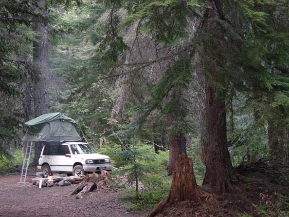

schaney wrote:Yes being able to use the tent unit both vehicle and trailer top I find to be a big advantage. There are places I just can't get my Sidekick into with a trailer and once you've gone tent topped, there is no going back to sleeping on the ground
With mounting one on a Teardrop the challenge is making sure the front cross bar isn't over the door frame so the load is carried down the wall. If you were planning for one during building, you could put in a header over the door.
