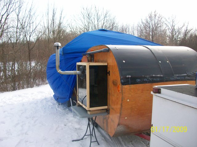

I think the biggest concern is oxygen depravation. A wood stove pulls a lot of air to feed that fire. In a small confined space where someone is sleeping it can sneak up on you and you may not wake up. Don't get me wrong I have a wood burner at home ( in the dinning room) and have used my toy pot belly stove in the teardrop. ( yes I left a window partially open). I have no concerns about either as they are installed safely and operated correctly.
