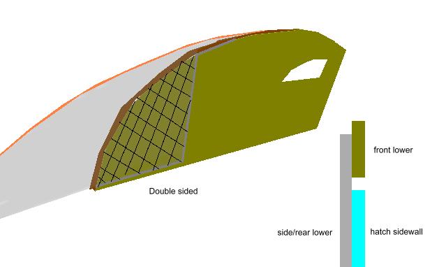

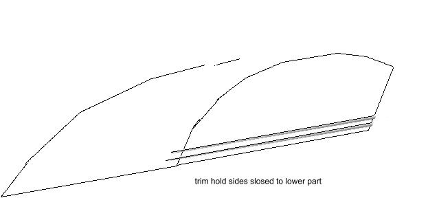

Postby leaded » Sat Aug 13, 2011 2:32 pm
mezmo: Once people see your creation
you'll be pestered by requests to make one for them. It might become a
profitable side line for you!
Ha.....well perhaps...but trouble is time
and as RAYVILLIAN notified about Mikes Alto design, theres a lot of similaritis, and Mike, you did give me some tip there! Havent seen that tread before, and glad we did now!
RAYVILLIAN wondered on my solutions on sidewalls.
, there seems to be some discussion about the sidewalls (hatch?) splaying by the Alto tread, ...The sidewalls are there only to shut the sides, and dont need to hold anything, so dont need much of strength, only to keeped it "locked" against lower sides.My plan gonna be fixed by using an extra outside profile around the downside., as a trimpiece going around nearby the edge of the hatch sidewalls.
I plan to make the front (lower) part wider as rest, so hatch sidewalls are sliding to similar size as front lower part. Not on outside as on the Alto idea. Then its possible for wind to catch it and to get splaying, and easier for water to come in under travel.Also possible that some trimparts could be fastned from the front part, and top hatchsides slides inside of theese to lock it from splaying in the travelling wind.

Postby RAYVILLIAN » Sat Aug 13, 2011 3:46 pm
Leaded I see what you are doing with the outside lip when the top is down. I built both the Winter Warrior and the new Road Warrior that way. I was wondering what your plans were for filling in the open space on the sides when the top is up.
Actually on both of my trailers the hatch is supported by the back wall both with the top up and with it down. I built the outside wall lips to keep the rain out when traveling as you are. I think it gives it a smoother look also wich would be good with the custom car look that you are doing. Starleen2's ladybug is the only one built without the outside wall lips.

Postby leaded » Sat Aug 13, 2011 6:32 pm
Well..for the first "wondering", most of the sidewalls on the hatch would cover some inches on top of the lower part, only not would be triangled part at the rear sides. Plan was using only fabric, but perhaps some clear fiberglas plate would be used.......if they´re not interfering to much on the interior.
The rear on the Tear would be as yours/ as on the Kampmaster.. a "trihinged" wall w/door who folds inside when closing. I also would belive this are supporting the hatch good enough at the rear for sideways motion. When open the tophatch sidewalls are tried to be made a little "tight" pressing softly against the lower part. And here´s gonna be some kind of gasket material to not scratch sides and keep weather/coldness outside...
One point of idea with the sidewalls kept smooth when closed, and "stepped" when open, is extra support when down, and another gasket on the edge keeps more water out......Also will the doubled front sidewall on lower part give more overall strength.
Thanks for the interest, and considerations for the build!!
