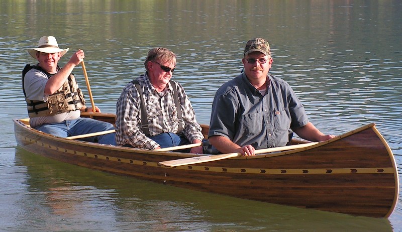

Yes built this one 10 years ago. 17 1/2' long, 62 #, cedar and redwood strips, pecan gunnels, ash and purple heart decks. Called a Redbird, a fast tripper style.
17513
I would highly suggest a project like this. Very rewarding, not very difficult. Several books out and online assistance. You can buy the strips already cut and routered to make the process faster.

Beautiful canoe, Prohandyman. Congratulations on your build. 60# doesn't sound bad to me!! I am fortunate to have easy access to all the supplies from Chesapeake Light Craft which is close to me in Annapolis, MD. Another check mark in the "do I want to do this" plus column.
