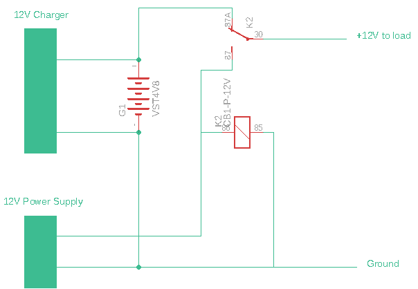

Would be interesting to have schematics of using a combination 12 PC power supply and smart charger. While on shore power the 12V Power supply would be taking electrical loads and smart charger charging the battery. While on battery the charger disconnects from battery and battery connected to the trailer. Can the above be done via a relay logic and 12V automotive relays?

OK, words did not suffice. Here's a schematic:Image
I used a 30 amp auto relay. You can see that when there is no shore power the relay is not energized and the battery supplies power. When you plug in, the battery is charged by the charger and is disconnected by the relay, which is energized by the power supply. The trailer now gets power from the power supply. It's very simple, reliable, and keeps charging transients and other stuff from harming your sensitive electronic stuff. Not that I have any. I went this route because chargers are not expecting loads other than the battery they are charging and I did not want to risk interfering with its operation.

Thanks, I am a visual guy and this helps. Now, does it make sense to add another disconnecting relay contact for charger, when there is no shore power or there is no concern to have it connected to the battery all the time?

It would do no harm, but I don't think it's necessary. Most of these smart chargers, aka battery maintainers, expect to be connected to the battery full time. There really shouldn't be anything in the charger that would drain the battery when the charger is unpowered.
