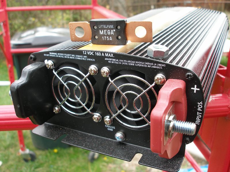

When you need to fuse a 1500 W inverter
Postby artfd » Wed Apr 29, 2009 1:31 pm
The stud size is 3/8". The hex nut is 9/16" This is the size of fuse you will need. I found these for sale at an Autozone or Advanced Auto Parts store in Albuquerque at $5 each. Branches of the same in Ohio do not stock these.
