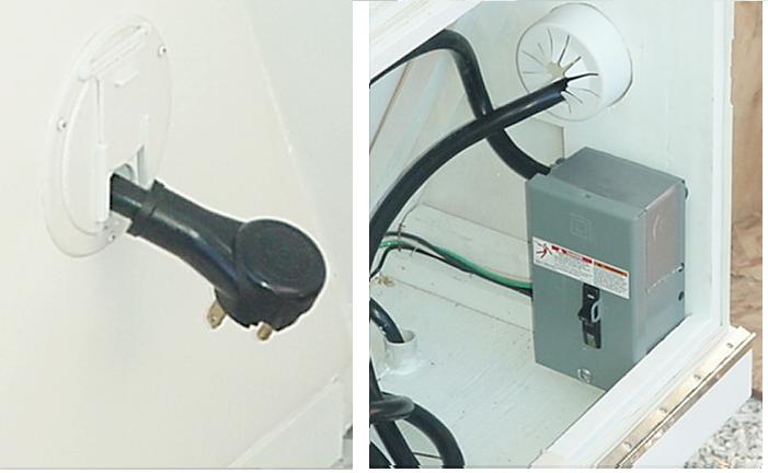

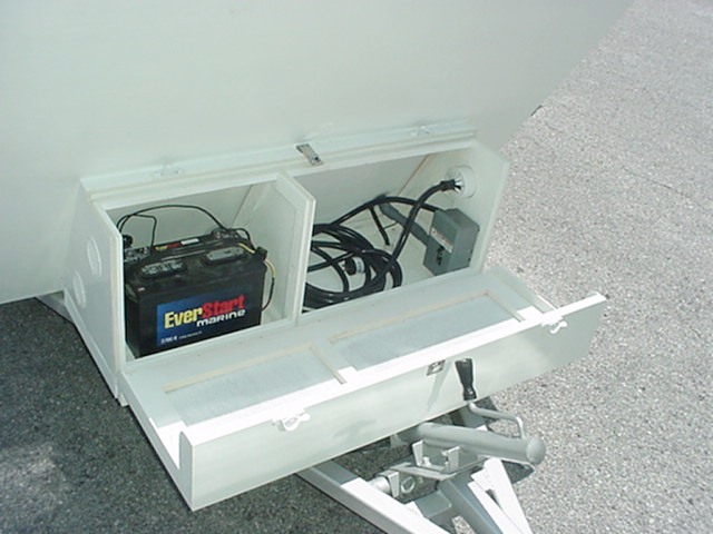

2. NEVER put a lead acid battery where gasses from it can be exposed to an electrical spark. I but my battery in one side of my tongue box, and the shore cable to the 30 amp main breaker to the other side, but the two compartments are sealed pretty good and the battery side is ventilated with two round plastic soffet vents in the end of the box.

6. I bought a regular 30 amp shore cable (25' long) from WalMart. I cut off the receptacle end and wired it directly to my main breaker in the tongue box. The cable feeds out through a cable port in the end of the box to plug into a shore socket. The cable is for 30 amp sockets and I have an adapter for connecting to 15 amp sockets (standard house type).
