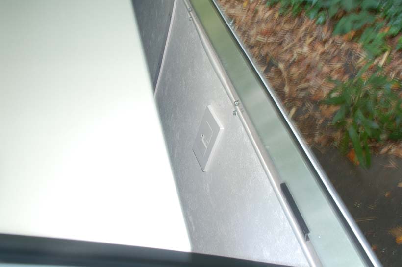

Postby wlooper89 » Mon Apr 27, 2009 1:04 pm
artfd wrote:It is not necessary for a GFCI to come with its own outlet. Home supply & electrical supply stores also sell a plain GFCI, which just contains the GFCI electronics, on/off switch and reset button. These are installed in the usual outlet boxes and protect everything wired "downstream" from them. I discovered them when I was wiring a GFCI circuit in my basement & just wanted a plain ol' GFCI switch on the ceiling where I would never plug anything into. I have found it difficult to test or reset a fully-plugged-in GFCI with outlets, and I have skinny fingers. Costs only slightly more than a GFCI combined with outlets. :designing:
This is a photo of one of those, mounted at the tail light compartment of my trailer. It protects the outlets in the galley and sleeping area but not the wiring in my tongue box where the converter and switches are located. More recently I added a GFCI there close to the shore power inlet. 8)
Bill
