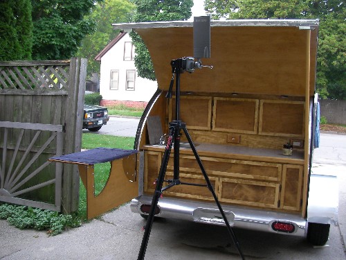

Here is a picture of my antenna and how I set it up. I Just bought a camera tripod at a flee market, the antenna is from Wal-mart for about $35. It is a Philips and is amplified. It works good up to about 40 miles depending on terrain.

Postby sdtripper2 » Thu Jan 08, 2009 10:04 am
BrwBier :)
<img align="left" src= "http://www.tnttt.com/gallery/image.php?image_id=27273"width="150" height="110" />
This idea shows that keeping it simple and using what you have works.
I like the simplicity of your antenna stand and it plays double duty.
No extra appendages hanging off your trailer either. No holes for screws,
or unsightly outcroppings. Just get the cable from the tripod to the back of
TV and yur good to go.
