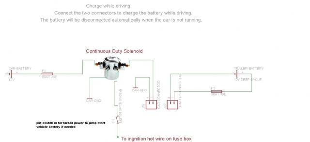

Postby bowhuntersd » Mon Mar 24, 2014 10:05 am
Found this and snipped it and posted in my gallery. gallery/image.php?album_id=3402&image_id=118187&view=no_count trying to figure out how to write HTML and posting pictures is not easy to me!!

Postby ntsqd » Mon Mar 24, 2014 10:28 am
Good find for wiring in the ~$20 battery separation solution.
The only thing that I would caution about is the note about having a switch for self jump-starting. That is a bad plan. Neither the conductors, connector, or the constant duty solenoid are able to handle the amount of current that can be present during a jump-start. If the connector used is an Anderson forklift charging connector and the cables are at least 2ga. then the constant duty solenoid will need to be replaced with a Ford type starting solenoid, but those solenoids are not constant duty -they are intermittent duty -so you can't use one for charging.

Postby webpager » Thu Sep 18, 2014 10:59 pm
Dang, another post 5 years after the subject started. But I like the idea of charging this way, so I'll add it to the idea file.
Instead of having to remember to connect and disconnect, you could add in a relay. The car starts, the circuit is closed or connected. Turn off the car, the circuit is opened and not pulling from the car's battery.
