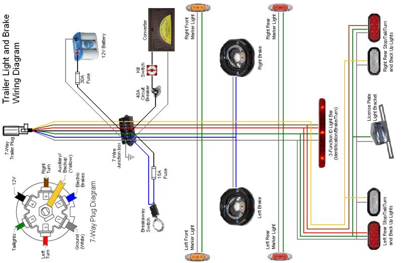

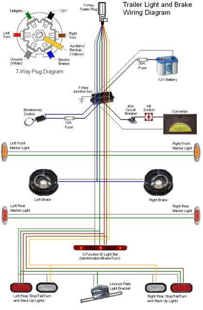

Postby danlott » Wed Nov 25, 2009 8:22 pm
This is my wiring plan. I will be able to charge while towing and also charge through the converter when hooked to 120V AC.
Sorry it is hard to see, had to fit within the picture size restraints.
Here it is sideways. It is a little bigger this way.
Dan
