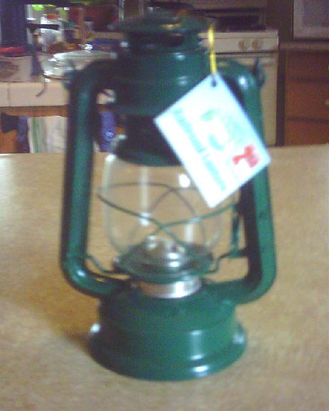

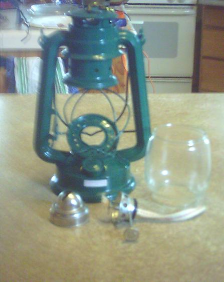

Here is the $ 2.50 lantern as purchased

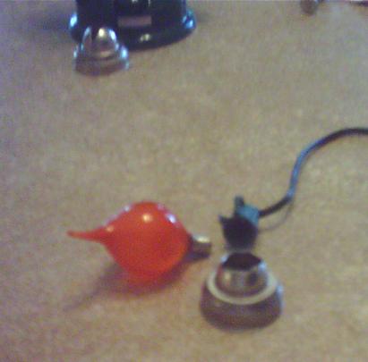

Here it is disassembled
With a 4 " grinder I widened the mantle to the inside diameter of the Christmas light socket ( a round file or a rotary file or a tapered grinding cone would be even better)

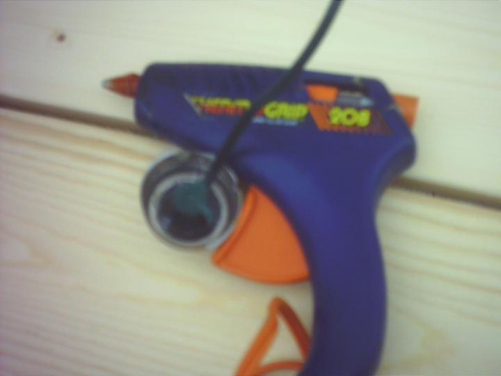

Turn the mantel over fill the bowl shaped void around the socket.
Drill a small hole in the rear of the fuel tank for the cord. Feed the power cord in and make your connections to the socket. This way your splice is in the tank. Wire nuts and tape or solder and tape should work. With the possibility of the thin tank cutting into the cord you may want to drill a larger hole and install a rubber gromet to protect the cord

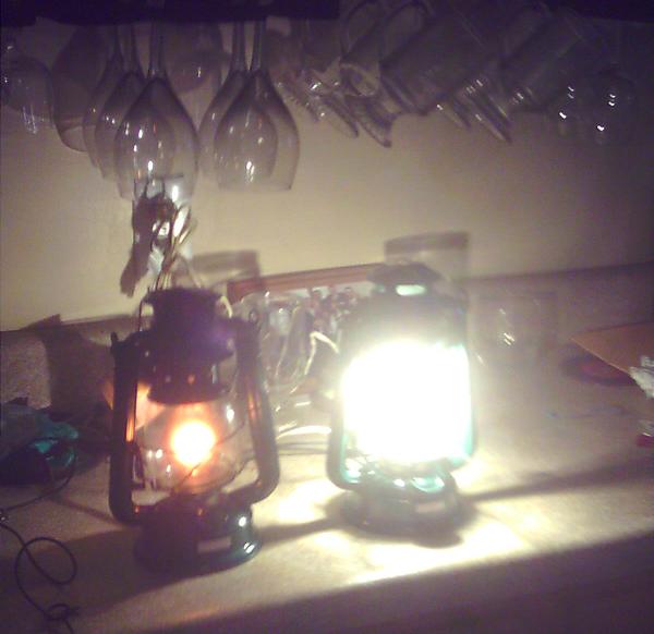

Here it is lit with a orange christmas light
In comparison here is a mini based high intensity bulb
It took longer to prepare and post this thread than it did to build these lights. ( about 45 minutes to build both ) and less than $4.00 each , even including the hot glue.

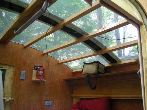

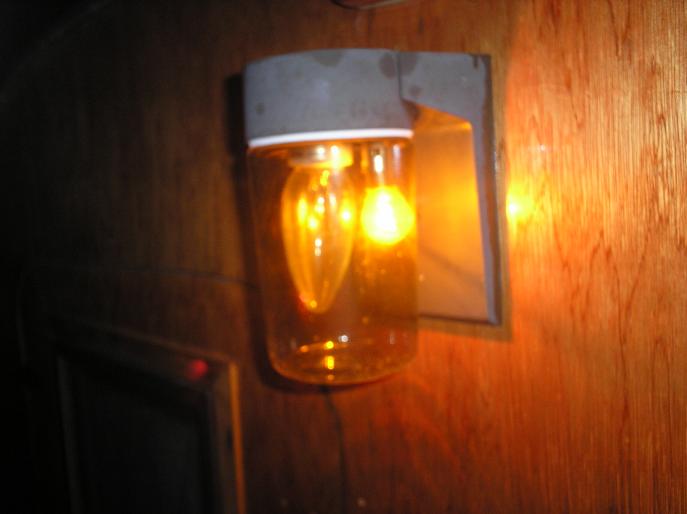

In Chubby I have the same lantern setup and in the top of the chimney I wired in a 12 volt DC dome light bulb. This let them work on 120 when available and 12 volt dc off grid. Did the same on the porch light you can see them in this pic.
You can't see them but trust me I did the same in these little lanterns.

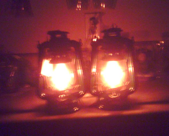

Took a night shot .
I like the orange bulbs they look more like a flame and they might attract fewer bugs.
