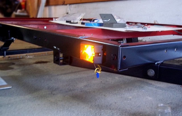

Side running light.
Postby Franco Novo » Sun Jul 12, 2015 10:12 pm
Ok, this was a little weird, First, the manual tells you to remove the lens to install, but....there is absolutely no need to do that.
near the front of the trailer are three holes, One large center hole, two smaller holes along side.
The manual says 'Put the brown wire through the big hole, and attach running light with two self tapping screws in the light kit'
Well, as you can see, there is a plastic plate on the back of the running light which is just as high as the rim
There is no way to push the wire through the center hole and tighten the light down, because the wire doesn't come from the center of the light
It sits on the back plate, and that creates a rocking motion ..hard to 'tighten' the lamp up this way.
on one side mount hole there is a metal flange for ground. again, sand the paint to get good connection.
Don't go wild here or your sanding will extend way beyond your marker light. I just used a 1/4" chisel to scrape away just where the metal flange will touch.
134005
Franco Novo
Posts: 51
Images: 48
Joined: Fri Jul 03, 2015 4:31 am
side running light installed
Postby Franco Novo » Sun Jul 12, 2015 10:21 pm
OK, the self tapping screws in the kit are way too small for the mounting holes provided
Also, I just ran the wire from the running light underneath...there are small u shaped cutouts on the top and bottom of the running light
Then used a couple of small bolts and washers from the spare parts can to fasten it down
No crimp connectors.....I just cut the brown wire & wire nut the wires together, and then fastened them at that point with a plastic tie.
Grounding seems fine...nice and bright running light.
I'll probably add more as I go along here.....hope this helps to get you started on wiring it up
It's really not that big a deal...just remember that if something isn't fitting right, there's always a way around it...as long as you have your spare parts can of little nuts bolts washers and screws with you.
Franco

Re: Wiring up the Harbor Freight Trailer
Postby GuitarPhotog » Mon Jul 13, 2015 12:04 am
Be aware that your wire nut connectors are not weatherproof and the connector and the wire may corrode when exposed to the weather leading to intermittent connection problems. Use a bit of dielectric grease to help prevent corrosion, and check all wire nutted connections frequently.
I much prefer properly crimped connectors, but there are places where serviceability demands an easily openable connection.
<Chas>
