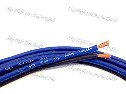

I found what seemed like a good price on wire on amazon with a lot of good reviews. Only now that it's here, I've realized that it's not all copper--it's copper-clad aluminum. (And was marked as such on amazon--I just missed it).
Is this... bad?
In particular, will it cause problems when I connect it to switches or fixtures that use all-copper wire?
Do I have to coat it in some special anti-oxidizing product? (If so, what?)
It if was a mistake, it was a $15 mistake, so not a huge deal, just--annoying.
https://www.amazon.com/Speaker-Car-Audio-Sky-High/dp/B00MR5K326/ref=cm_cr_arp_d_product_top?ie=UTF8
Here's the manufacturer's pic:
