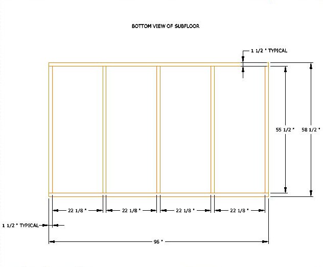

Glue and screw the (5) 55 ½” subfloor studs to the plywood as shown in the drawing below.
Here's a pdf of that drawing...
http://www.mikenchell.com/images/subfloor.pdf
Glue and screw the last 8’ long piece of 1x2. Let the glue dry overnight.

Postby backwoodsman » Mon May 23, 2005 6:45 pm
mikeschn wrote:Glue and screw the (5) 55 ½” subfloor studs to the plywood as shown in the drawing below. (drawing forthcoming)
Mike-
Please submit the drawings, I'm unclear on what you mean by this.
Thanks,
Greg
You don't know what you don't know!

Postby mikeschn » Thu May 26, 2005 7:33 am
Mike-
Thanks,
Greg
Hey Guys,
Sorry the drawings are taking so long... I am trying to learn a new cad package (the one that angib uses) so that I can make clear PDFs. My solid modeling package doesn't do drawings very well.
But I have a 4 day weekend, I'll be doing some studying... and maybe I can even crank out a drawing or two.

Postby mikeschn » Fri May 27, 2005 5:48 pm
backwoodsman wrote:
Mike-
Thanks,
Greg
Hey Greg,
I put the drawing up just now... Hope that helps... (It's in the first message in this thread)
