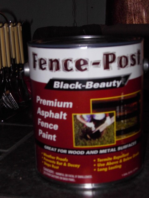

Postby backwoodsman » Mon Oct 31, 2005 8:09 pm
mikeschn wrote:
Use roof tar to coat the underside of the floor, making sure not to get any tar on the sides where the walls will be attached.
Roof Tar! Roof Tar?
What kind of roof tar?
I went to the hardware store and they recommended
204 Plastic Roof Cement made by Henry Company
http://www.henry.com/Patching_Repair_Cements.175.0.html
Will this work?
What did you use?

Postby stjohn » Mon Oct 31, 2005 8:17 pm
This is what I used could not find what everybody else used they said it was the same thing Was really eeasy to work with got it at tractor supply
Mike

Postby madjack » Mon Oct 31, 2005 10:24 pm
Greg...that may be a little heavy bodied...the link states that it is TROWEL grade...it would probably work but you should try and find something a little more "liquiddy" or "brush/roller" grade...that stuff may be more like tryin' to drink the corn mash instead of the drippin's :D
madjack 8)
p.s. we used MinWax ClearShield a heavy bodied polyurethane that is UV protected and outdoor rated...it is expensive but we had it left over from a previous job
