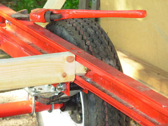

Yeah Mike, I used the two steel cross members to reinforce the side rails of my 1800# HF tlr. I then added a wood cross member before doing the floor. Here's pic of the added wood. It doesn't show the bolt thru to hold it in position but I just used a 2 1/2" lag screw on each side. It's actually held in place by the side rails as I trimmed & notched the ends & had to 'turn' it in with the pipe wrench shown in the pic. Also the floor is bolted to all cross members so the wood member is mainly there for my own satisfaction. More pix in my album -

Hey Harvey thanks, actaully your the one who got me thinking about it, I was just about to add the plywood to the Framing. got to loking at your Album, and here I am. looks far stronger than stock. I disassembled the Frame and have it layed out on the floor, Looking at Axel placement and what ill need to do to Move the axel back. I have it currently at 45" from the rear but thats after extending the Rear frame by laying 2' Angles over the back bolted in place adding an additional 12' to the Frame. Im guessing anywhere from 35 to 40 -ish inchs from the rear im guessing. I hope get pics posted shortly......no really
