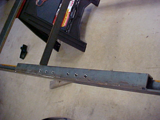

How do you attach the axle to the frame?
Postby Esteban » Wed Mar 07, 2007 6:29 pm
Could somebody show how you attach the Dexter axle to your frame? I'm planning to use 2x2 square tube for the frame. I'd prefer a bolted on way of doing it, rather than welded on, so it could be moved a little if I needed to change the TD's balance. Pics or a drawing would help.
Steve B.

Postby Ken A Hood » Wed Mar 07, 2007 6:35 pm

Postby asianflava » Wed Mar 07, 2007 8:41 pm
The easy way would be to bolt the brackets to the axle, tack the brackets to the frame, remove the axle from the brackets, weld the brackets to the frame.

Postby madjack » Wed Mar 07, 2007 10:15 pm
...I stol...errr, borrowed this pic from SteveH's album(sorry Steve) which shows his adjustable setup...the pic is looking at the bottom...a better choice for a tube frame would be to get it close and IF needed, use loading to affect the balance...

Postby Esteban » Wed Mar 07, 2007 10:36 pm
I'm linking to a picture from the web that shows one way to attach the axle to a square tube frame so you'd be able to move it to adjust trailer balance/tongue weight:
http://new.photos.yahoo.com/chrischristenberry/album/576460762313810811/photo/294928803086224685/25 (Wish I knew how to borrow this pic and post it here...I tried) But this moves the axle mounting holes inward maybe an inch or two on each side and would seem to make ordering the right length axle harder.
It's somewhat similar to the way shown above by MJ/Steve Frederick...though I wonder how you'd get a nut on the bolt and be able to tighten if you built your frame the way Steve F. shows.
:thinking: Could a section of C channel be welded to the bottom of a square tube frame in the axle area so you could mount a Dexter torflex axle to the C and adjust it's (the axle) location for the best TD blance? The C channel would have extra bolt holes on it's bottom for moving the axle placement forward or backward. Axle mountings would be centered under the sides of the trailer frame like normal. Does this seem like a good idea?

Postby madjack » Wed Mar 07, 2007 10:51 pm
SB...yahoo doesn't allow hot linking of picks...so the link is what ya gotta do................. 8)
