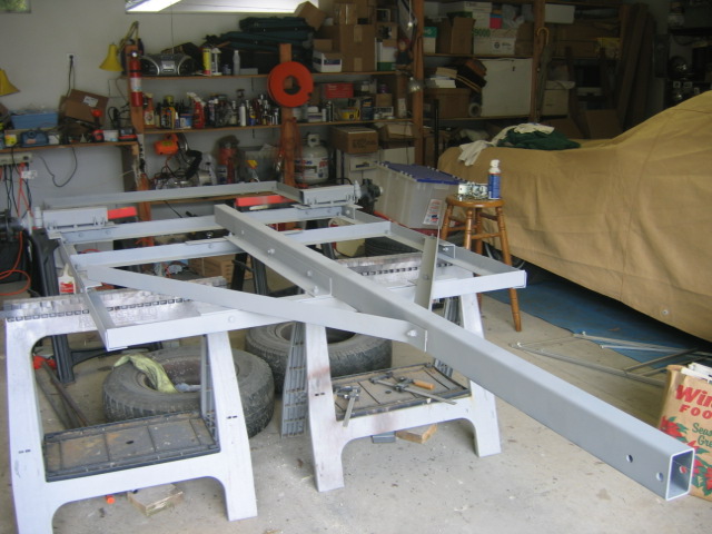

Chuck Craven wrote:Every thing is 3/16” thick streusel steel.....My frame has been gone over by a professional engineer

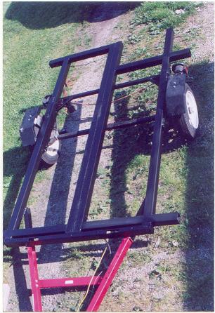

madjack wrote:..the frame material of my current build is 1x2x3/16 forged "C" channel...very strong and at 5x9, it is lighter(and cheaper) than the last one(4x8) made of 2x1/8th tube...
brian_bp wrote: Angle, on the other hand, makes no sense to me for frame rails.
angib wrote: It's fairly easy to work out how strong a trailer frame is - the difficult bit is deciding how strong it needs to be and there aren't many engineers who know the answer to that question.

angib wrote:Chuck Craven wrote:Every thing is 3/16” thick streusel steel.....My frame has been gone over by a professional engineer
Chuck, I'd love to see what calculations the engineer did. It's fairly easy to work out how strong a trailer frame is - the difficult bit is deciding how strong it needs to be and there aren't many engineers who know the answer to that question.
Andrew
Nitetimes wrote:brian_bp wrote: Angle, on the other hand, makes no sense to me for frame rails.
I'm curious as to why???
It made perfect sense to me, easy to use, strong enough for the application and it also provided a good low mount for the floor.
brian_bp wrote:Almost no one actually takes advantage of this possibility of lowering the floor a couple of inches, although that's one slick setup! I'm not really sure, though, what the wood set into the angles does, other than serving as a nailing strip for fastening the body (which is a worthy function in itself). Since it's laying right on the frame structure, it doesn't seem to have much structural purpose.
You got it right on the nose. It's main purpose is as a nailer, but it is kinda structural as it ties the box and frame all together. It was cut to fit the height of the inside of the angle. If you use angle in this configuration it gives you a mounting place for your spring hangers but it just leaves and 1/8 in strip of steel on top. If you use deck screws to attach the 2x's it keeps everything pretty simple.
The way I built this one makes all square cuts on the steel, no miters or notching to fit it up. The tubing was just used for a little extra strength for the tongue mount, really wasn't necessary.
