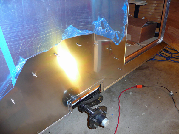

The inside clearance on my teardrop is a little more than 3/4". I have seen several schools of thought on the forum on clearance, but it seems that a torsion axle can get away with less clearance than a leaf-spung axle. My guess is that this is because a torsion axle limits the wheel/tire movement along just one axis. I guess time will tell.
On a related note, I thought I'd offer one of my learning experiences/work-arounds that you may encounter. My axle is a Dexter torsion axle that, unlike the Flexiride, has a fixed torsion arm start angle. I wanted a low-slung teardrop so I ordered the axle with a 10 degree up start angle. I thought I had done my math but I did not take into account the clearance between the torsion arm and the sidewall extending over the frame.
As you can see in the picture, I had to "notch" my sidewalls to allow for movement of the torsion arm.
On your frame drawing, you show the torsion arm parallel with the frame - a zero-degree start angle. The torsion arm will rotate with the weight of the teardrop - about 1" for the Dexter - and with suspension travel. With the Flexiride, you can adjust the start angle; however, depending upon your desired ride height, you may need to notch your sidewalls.
Sincerely,

As far as brakes, I did not order them with the axle. (I did order the axle with brake flanges in case I decide to add them later.) My tow vehicle is a 2007 Honda CR-V. I have towed my HF utility trailer with a 800+ pound loads (plus the 200 pound weight of the trailer) several times. The CR-V handles the trailer and loads very well. I did have to allow greater stopping distance and on inclines the CR-V would downshift to 3rd. Other than that, I don't notice the trailer. It will be interesting to see how it does with our teardrop.
Take care, Tom
