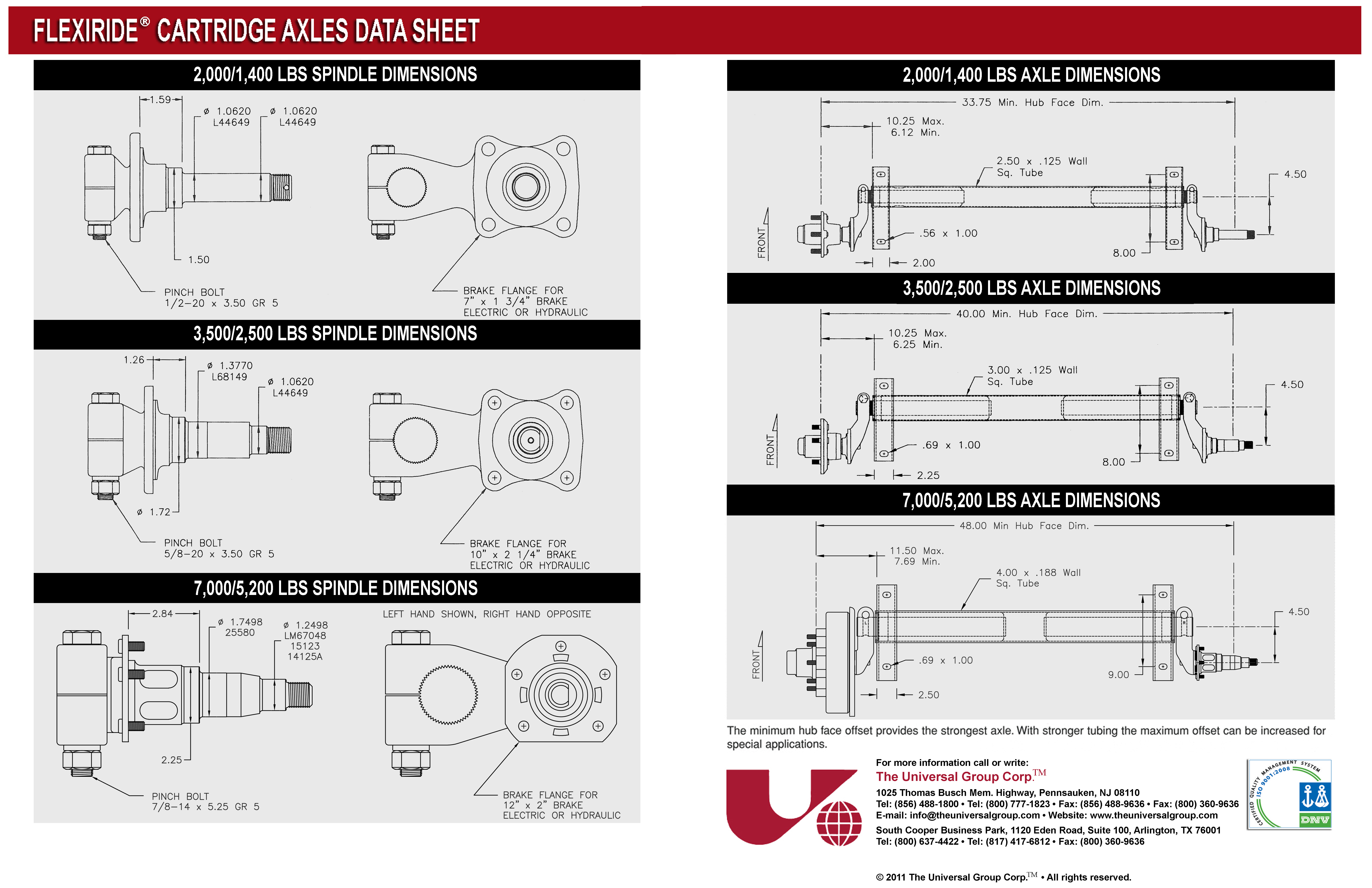

For technical data on Flexiride, go to the manufacturer's web site:
http://www.ucfamerica.com/tech.html
There may be more information than you wanted and spread across several different documents, but it's all there somewhere. You do need to be able to read a technical drawing.

as i mention, i already read almost everything about that website. Could not find any drawing of the mounting options or recommendation. That said, i have no presomption to say i m good at ready this stuff, i have no knowledge of mechanical of building stuff... That s why i m writing here to see if someone can help me and explain to me in more simple terms?!

Followed the link that Angib posted, double clicked "Data Sheet" and there was the technical drawing that he spoke of. http://www.ucfamerica.com/FlexirideTechnicalLiterature/Axle%20Data%20Sheet%20All%20Sizes.jpg
