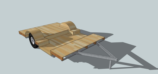

I was looking for some opinions/criticisms on my frame design for my tiny canned ham. I've never done this before, so any advice would be helpful.
I'm not a welder, so I plan on paying to have this fabricated.

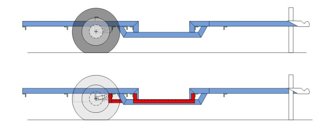

It will be a 10 foot box with a 3 1/2 foot tongue. I want a drop floor similar to a Scotty with the drop in the main rail to make for easy access through the door. Although the design shows a drop on the driver's side also, it won't be for a door, its to keep symmetry and to add extra storage.

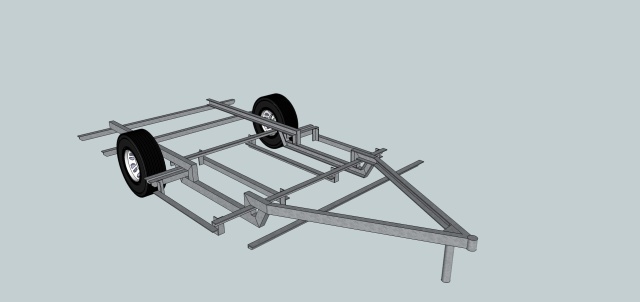

#9 Dexter axle: 10 deg down; electric brakes; 4'4" bracket dimension; 5' 6" hub face
ST205/75R15 tires

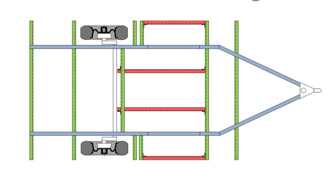

Main frame rails (blue): 3" x 2" x 1/4" C-channel
Cross members (green) 2" x 2" x 1/8” angle
drop floor (red) made from the same angle
Ground clearance, assuming full load for axle, would be 13.5” on the main trailer and 7” on the drop down. The axle is rated at 2200lbs and I am aiming for 1600 lbs max so it should set higher.
