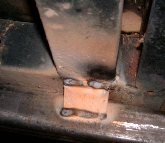

I built chubby on a damaged H.F. trailer . I wound up using the axle cradle and the tongue as the boulder they tried to load on the poor thing did in the frame. :?
When I was finished with my build and with him ready to camp I took it to the scrap steel yard and asked if they would weigh him. The result 1830 pounds. I have no idea what frame was originally selected as I bought it off of Craigslist for $75.00 I did reinforce the tongue and built a light gage tube steel frame out of some dock railings to replace the bent and mangled frame but the springs are the springs and the tires are the tires and it is still going down the road just fine.
My biggest concern was the flexing of the stock tongue so a center member was later added and welded to the center run of the tubing.
New member is on the bottom the dock rail frame on top and a gusset plate welded to both....Image
