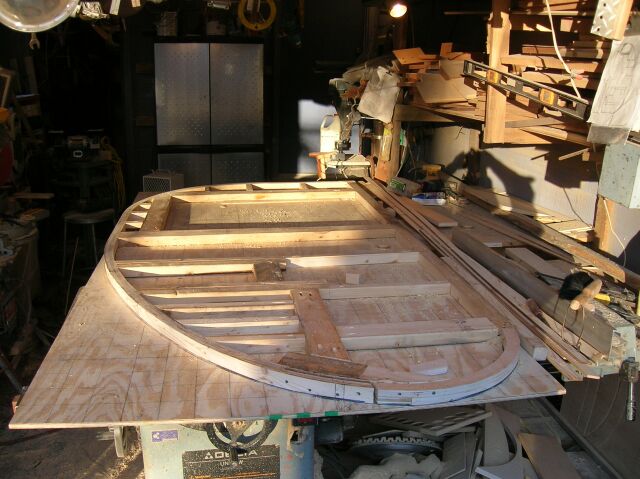

Now I am looking at the Generic Benroy plans but my sides are not 3/4 plywood. here is one of my sides glued up. It is 1 1/2 inch thick.
Where do ya'll suggest that I look in the forum for some information about attaching sides like I have to the floor?

As you already found out, you'll attach them the same way as with 3/4" sides. Just use longer galvanized drywall screws...
Looking good there... any idea what the sides weigh as shown?

Jim, in my 45 years experience in the truck/trailer business it won't make any difference at all. If your trailer was 50' long it might dog-leg somewhat but for such a short trailer you won't even notice and I would suggest to just continue on with your build.

My very first trailer was the HF 4x8 underneath my first benroy. The difference from one side to the other was 1/4". I certainly didn't plan it that way, and I was in shock once I found out. But it tracked wonderful on the highway, and never caused a moment's grief. So I wouldn't worry about it.

i can tell you probbaly what happened.you see when you weld tubing together you have to spot weld ever 1 1/2 in to keep it from wracking because when you heat it up that much in one spot it gotta move.i discovered this on another project,try this weld 2 20pieces of angle in a 90 clamped in square possion then check them with a laser mine were of 1in on the far end.thats what spot welding is for.i hope this helps.

If you don’t do any thing and leave it as is. The trailer will dog track by less than one inch. Most full size vans GM, Ford, Dodge will dog track by 2” to 4” and you will never feel the difference when driving. Just looks goofy going down the road from behind.
Tires will not ware any different that if it was in perfect alignment.
Remember that the trailer is a three-point connection to the road and it will track behind your tow vehicle no matter how out of alignment it is. With a slight dog tracking there will be no difference in stopping. If it has a large dog track then the trailer will pull to one side when heavy stopping is done. That could be a problem like jackknifing the trailer or pushing the tow vehicles rear to one side. But with the small amount you have in alignment you should have no problem. You can make up any difference with the tong alignment. Just measures from the center of each hub to the center of the hitch, both sides are the same you are good to go.
