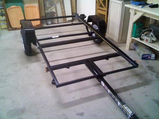

Postby regis101 » Thu Aug 13, 2009 8:24 pm
1500# capacity and the trailer is 190# so there is about 1300# to play with.
I'll try to keep my GTW at ~1000
As previously stated, the five cross members are below the perimeter framing. I'm gonna get some 1/8" aluminum flat stock to make up the difference. I desire a flat floor to start with. 1/8" may not seem like much. It's more of an annoyance to me. But for $350. it's a good deal, IMO.

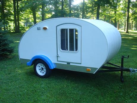

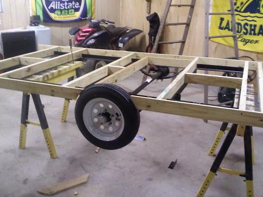

Postby prohandyman » Fri Aug 14, 2009 5:25 am
Regis
This is how I used the TSC 4x8 frame. Added 2x4 for floor framing
This is the end result. Weighed in at 940#
Dan

Postby regis101 » Fri Aug 14, 2009 8:51 am
Great shot of the trailer. And a nice rig you built there.

Postby BillZ » Sun Feb 21, 2010 11:05 pm
Prohandyman,
Nice looking 2x4 frame and trailer!
Forgive my newbie question, but how and where is it attached to the trailer?
How big are the wheels? Are they stock?
