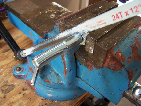

I then sawed the hex head off.

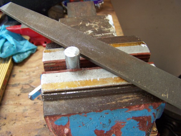

I smoothed out the sawed end with a hand file.

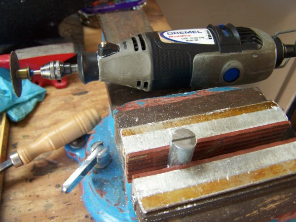

With my Dremel tool, I cut a slot for a flat screwdriver blade.

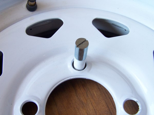

My OCD caused me to add a little Teflon tape to the exposed portion of the threads just for the heck of it (probably a little overkill).
To use the helper stud, you simply screw it into one of the stud holes in the trailer hub and rotate it to top dead center. Hang the wheel on it in one of the holes and let the wheel settle into place. You should be able to easily insert the remaining lug bolts. After tightening all the other lug bolts, use a screwdriver to remove the stud helper and install the last lug bolt in its place. I didn't try it on my trailer wheels but I laid it in the spare and this is what it looked like in the hole.
