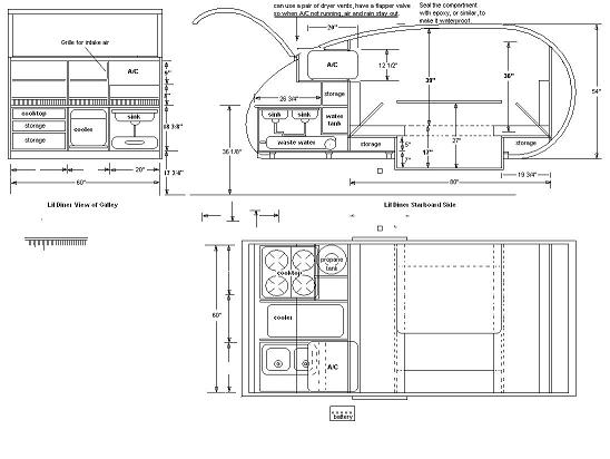

Postby doctormap » Thu Apr 13, 2006 10:36 am
Here is how I plan to build over the wheels:
http://tnttt.com/album_ ... ic_id=7647[img]
I am using the "Lil Diner" building CD I bought from Steve Frederick, with some minor modifications. I can't afford to buy a 5 ft. wide trailer, so I am building over the wheels. I will be trying to build as light as possible, as I plan to pull this behind my '48 Studebaker, to car shows.[/img]
