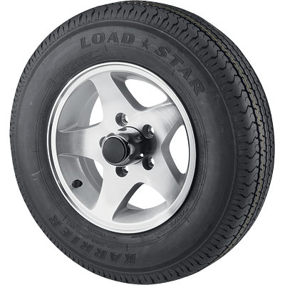

Postby toypusher » Thu Mar 16, 2006 10:14 am
toypusher
Posts: 43040
Images: 324
Location: York, PA Area

Postby Gerdo » Thu Mar 16, 2006 2:07 pm
