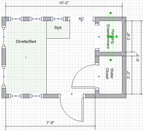

Well, after playing in Visio today, here's what I came up with. In order to accomidate the dinette that I was looking at. I had to widen it by 5 inches total. Image

I think you need badly to do a reality check on what you're thinking of doing. The drawing you've posted shows loads of 4" thick walls - even internal ones! There is no way this is compatible with building on a 1800lb trailer. And it's a huge structure to get just a 42" wide bed - that's a decent-sized single bed, right? You don't need even a double bed, but you need a 39" x 24" hanging locker?
Sorry if this seems negative, but it's better to get this sort of basic stuff right before you start. If using Visio to make the drawings is causing the least trouble, stop using it and draw on squared paper at a convenient scale. It's a good design, not an attractive picture of it, that you want.

Ooops... I noticed that but couldn't figure out how to fix it in Visio. I was planning on using 2x2s to do my framing with. I may just try some graph paper. ;) I never could get the hang of CAD. ;(
