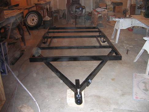

I’m working to finalize the specs for my trailer frame so I can get the welder going on it. I’m trying to keep the overall weight down since we’ll be towing with a small car. The welder wants to go with 2x3x1/8 rectangular tubing for the A-frame tongue (I’m happy with that), the same tubing for the 5x8 perimeter of the frame, and 2x2x1/8 square tubing for the cross-members. I want two cross-members, one at 28” center and the other at 77” center from the front. I’m also going with a Dexter Torflex axle which gives me a third structural cross-member and will be around 54” from the front.
I know lots of teardroppers are using 2x2x1/8 tubing and I’m comfortable with its strength for the rectangular frame and cross-members. Then I came across a thread on the forum http://www.tnttt.com/viewtopic.php?t=4918 that discusses 2x3x1/16 rectangular tubing. Powderburn used it on his Predatear, and Andrew later chimed in saying it had the exact same strength as 2x2x1/8 square tubing, but was about a third less weight. That sounded like the ticket to me. If I used it for the 5x8 perimeter and 2 cross-members, it would drop my trailer weight by darn near 60 lbs from what the welder was suggesting! Or by 36 lbs if 2x2x1/8 was used all around!
Has anyone else used this 2x3x1/16 tubing? Andrew’s data tells my geek brain that it is the strength equivalent of 2x2x1/8 square tubing (Andrew - where do you get section modulus info from, do you calculate it yourself or pull it off a chart somewhere?), but my complete lack of experience in this area, its apparent lack of use by the teardropping community, and the paranoid mom part of me who wants to be sure I’m pulling a safe trailer makes me a bit nervous. I’m sure the welder will think I’m nuts and try to talk me out of it, and unless I have some good ammunition, he’ll probably succeed. I only have two data points: section modulus (which I really don’t even know what it is, but is apparently indicative of strength), and Powderburn’s tear.
Now, there was some question in the original thread about if it was actually 0.083 thick (~1/12) rather than 1/16, but that is still stronger and lighter than 2x2x1/8.
Why isn’t this more widely used by teardrop builders? It seems like a great choice for being strong and light weight.
