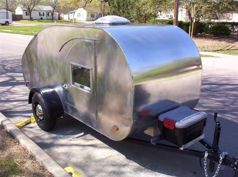

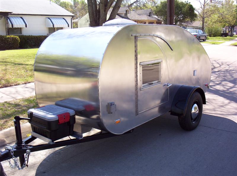

I have a 50deg. hitch setup using 2x2x1/8" HSS.
My welder is coming over in a few days and I wanna be prepared.
What provisions should I have on the trailer for safety chains?
KA wrote:Why is it preferable to bolt your safety chain instead of welding it?
Gage wrote:Besides, welds break when you really want them to hold. A pair of 'U' bolts work great.
Have a good day.
Melvin wrote:Gage wrote:
What happened?
12.4 Drawbars Safety Chain Attachments
The chain must be permanently attached to the trailer, shackles are not permitted.
For trailers up to 3.5 tonnes ATM, the safety chain attachment can be by welding. The weld must extend around 50% of the circumference of the link and the adjoining link must have free movement.
For trailers over 3.5 tonnes ATM safety chain attachment must not involve welding or deformation of the chain. Suitable pin-lock couplings should be used.
The safety chain attachment must be located as near as practicable to the coupling and where 2 points of attachment are required they must be mounted one on either side of the centreline of the drawbar.
The safety chain attachment must withstand the following minimum forces, separately applied, without incurring either any residual deformation that would interfere or degrade the function of the assembly, or any breaks, cracks or separation of components
Longitudinal tension (N) ...................... 9.81 x ATM (in kg)
Vertical Load (N) ................................ 0.5 x 9.81 x ATM (in kg).
Gage wrote: The only damage done was to the trailer jack. Ground off about 6". The only thing that really scared me was when it headed for the desert. I could just see it going end over end. If that had happened, because it was only about 70% complete, the whole teardrop thing would have been scraped.
