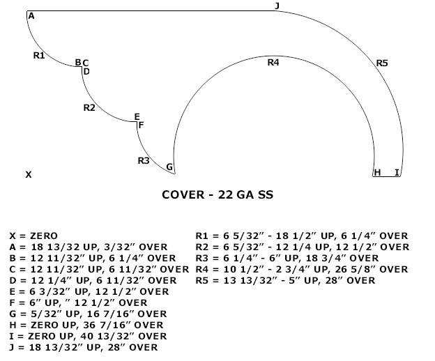

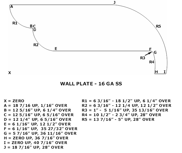

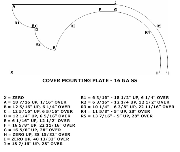

I've been waiting almost three weeks now to get six pieces of stainless steel cut at work on our plasma cutter.
I need either a DXF or DWG files for our programmer to enter into the burning software.
To help speed things up, I've created these three drawings (Below) with refernce points and radius sizes to make it easier and faster for someone that knows CAD.
Everyone at work, including myself are very busy... Just wish I knew how to use CAD... I'd be putting those fenders together this weekend.
I'm hoping someone here would be able to draw up what I need on CAD and shoot me the file.
Columnes on the left are reference points. Columnes on the right are radius sizes and radius center point references.
Thanks!
It sucks not knowing how to use CAD...

Dean,
Years ago I programmed and operated CNC drills and routers for a circuit board company. When I did my programming all the work was in finding the coordinates. What you have in the images would have been more than enough to complete the program. Have you shown what you have to the machine operator? I can't imagine he doesn't have the ability to key it in manually and with what you have there it wouldn't take any more than 10 minutes to input. Then again I have no idea how his cutter works, I'm basing this on what I worked with. If he uses G-Code for the program it should be enough.

Done. Dean, see email.
