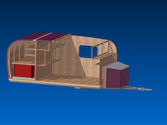

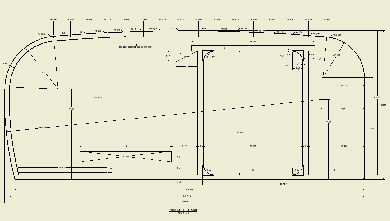

Conch Fritter has curves front and back, kind of like a Benroy. I do not have the classic hatch design, instead, my bed is on a raised stand and the galley fits underneath it. This allowed me to create an inset rear access door. The galley then pulls out of the back and then kind of unfolds. I never, ever get any leaks, as I have absolutely nothing going through the roof, front or upper rear areas.
132802
132972
dave
