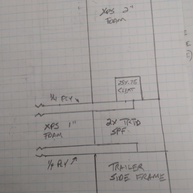

There are countless ways to build a floor. I have 24" on-center trailer framing so here is a rough drawing of what I did. 1" XPS sandwiched by 1/4" CDX. I cut the outside frame from 2x6 treated SPF lumber. There's a little bounce but not when I'm kneeling or sitting on the floor. Just when I was installing the floor. The cleat under the 2" XPS is 3/4" x 1 1/4" (not 3/4 x 3/4 as drawn). I undercoated the bottom with a generous layer of Black Jack and then used 2" wide aluminum duct tape where it sits on the frame so it wouldn't stick. I intend to prop the cabin up to tuck in the PMF under the cabin frame.
Trailer is the Sterling 4x8. I ordered it through Tractor Supply but it is offered by the Orange store, Lowes and others. I chose to insulate the floor because it was suggested that condensation under the mattress is less likely. I can't argue for or against that. I just went with that advice.
