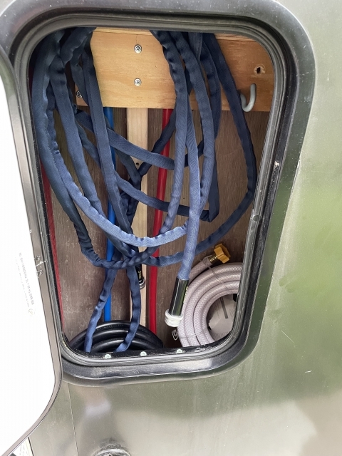

Postby jaws_1972 » Sun Jun 05, 2022 10:31 pm
View of the water tank box from the outside. Looks like it flows with the rest of the camper.

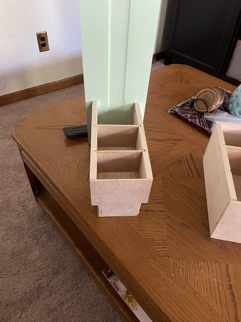

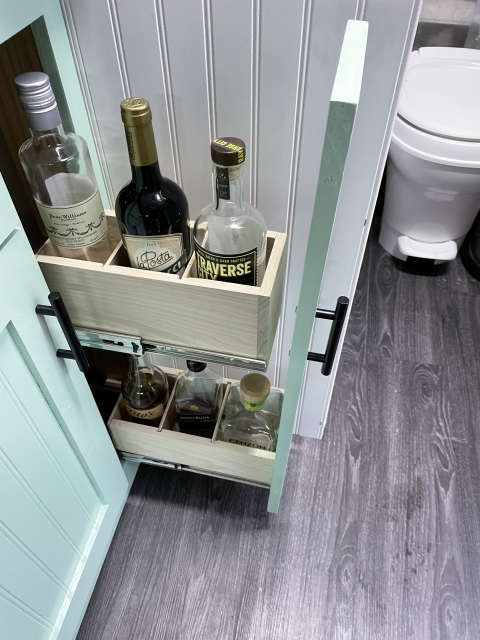

Because the storage nook took some of the cabinet area I had an odd space to utilize. I was thinking I would try to use it for sheet pans or something, but nothing really fit the bill. Saw a nice post from Karebru and decided to borrow the idea. Now I have a full size bar :-)
I was limited to 5.75" width and I needed 1" for sliders and 1" for the 1/2" thick side boards. That only left 3.75" for bottle width, which was mostly fine. However, I wanted a space for my 4" tequila bottles, so I got creative. Worked perfect since they are shorter bottles.

jaws_1972 wrote:Because the storage nook took some of the cabinet area I had an odd space to utilize. I was thinking I would try to use it for sheet pans or something but nothing really fit the bill. Saw a nice post from Karebru and decided to borrow the idea. Now I have a full size bar :-)
Yes very creative.. :thumbsup: :thumbsup: :thumbsup:

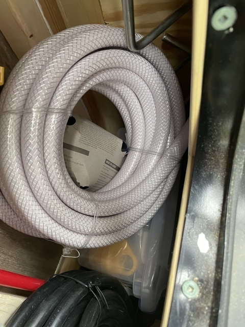

Storage Space
Postby jaws_1972 » Mon Jun 06, 2022 1:24 pm
The extra effort to make the storage space has paid off. I had this idea stuck in my head from owning the previous camper and wanted a place to put the camper "stuff". Seems to have worked out well for hoses, tools, cords, etc. There's still some room higher up that could be utilized with the proper organization of hooks, etc.

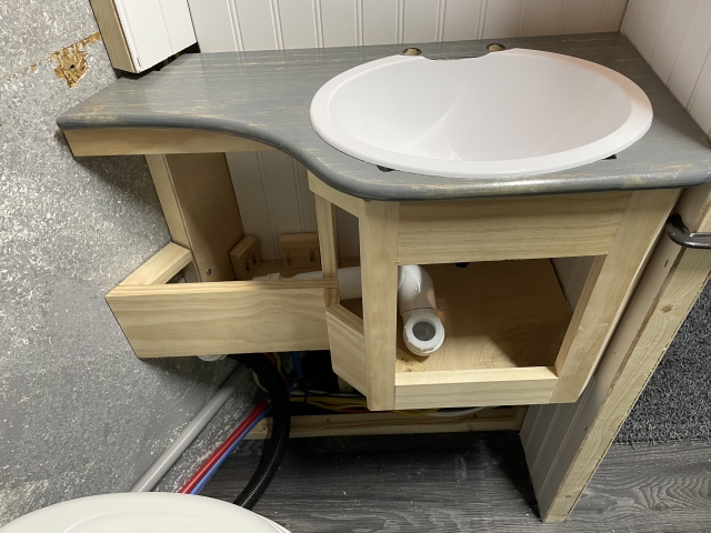

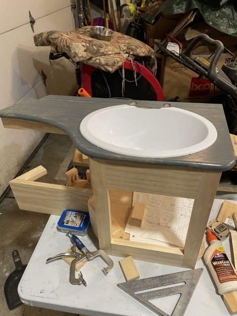

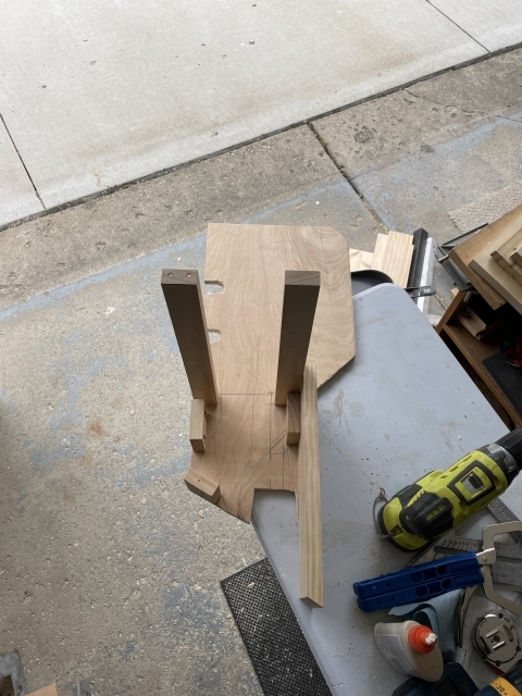

Postby jaws_1972 » Thu Jun 09, 2022 9:48 pm
So the bathroom vanity insanity has commenced, or better known as the joys of cramming a bathroom into the V-nose of the trailer.
When I framed the bathroom the trailer wasn't sitting level, the installed floors weren't true, the plywood finished walls were not great to reference, and the roof had the same issues as the floor, not quite level. So I think I got one wall quasi square with the rest of trailer and everything else was just "eyeballed". Needless to say I've been dreading figuring out this vanity since I framed the bath. After some thought I grabbed a scrap pc of 1/2" ply and sketched out the vanity counter-top that I had already scroll cut. Decided to use that as the bottom of the vanity and then everything just fell into place.
This looks like the start to the model battleship that I always wanted to build as a kid.
Starting to take shape with the pocket-hole face frame built.
Temporarily installed in it's new home.
Still have some finishing to do, as well as a shelf and door to make. I decided to take a break and moved the trailer back to storage lot for now. The neighbors have been super nice about me leaving it in the driveway for the last month, but I've really pushed that 48hr/wk township rule...
I'll finish the vanity, doors and some other items with it offsite and then do the final install. Eventually I'll make the upper cabinets for the kitchen, but really just want to go camping in it this summer.

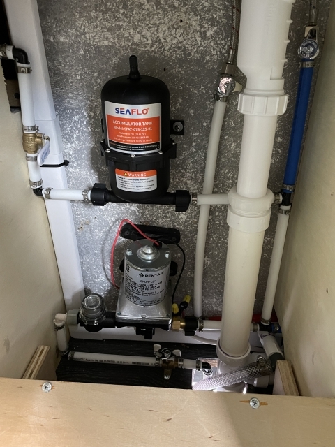

Nothing seems to stay the same for long. After finishing the fresh water tanks I was able to do a proper trial run with the water pump. The flow wasn't great so I decided to adjust the pressure and bypass switches, only I didn't have access to them in the original configuration. So after doing some remote adjustments to the water pump I decided to re-plumb everything. New configuration keeps the pump cooler versus being under a board, and also gave me room to add a shutoff valve prior to the water pump to be able to isolate the system from the fresh water tanks.
The water tank shutoff valve is on the floor and the ball valve to left isolates the city water from the rest of the system. Probably will get rid of the wire nuts once I'm satisfied with the install.

Postby Staryder61 » Fri Jun 10, 2022 9:39 am
jaws_1972 wrote:So the bathroom vanity insanity has commenced, or better known as the joys of cramming a bathroom into the V-nose of the trailer.
Surprised :o by the first picture Jeff..
What's he doing now? :) That's a what? :roll: A spare tire holder maybe? ;)
Wow that vanity turned out great.. :applause: You are doing great buddy.. waiting to see what ya do for the upper cabinets.. :thumbsup:
