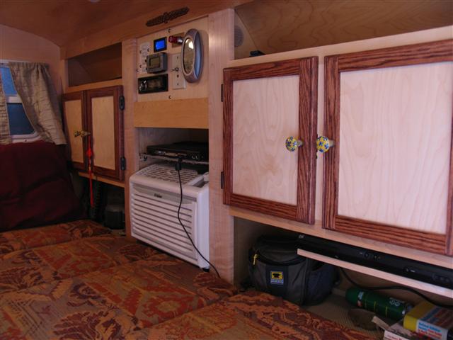

Staryder61 wrote:The 5000 btu window unit is small enough to go right between the trailer wall metal framing.
So, I'm going to go through the side of the trailer with the AC, using 18" full extension drawer slides making a slide out on top of a short cabinet inside the trailer.
bdosborn wrote:Staryder61 wrote:The 5000 btu window unit is small enough to go right between the trailer wall metal framing.
That's what I did on the trailer:
flboy wrote:Looks like a great plan! Can't wait to see the finished product.
