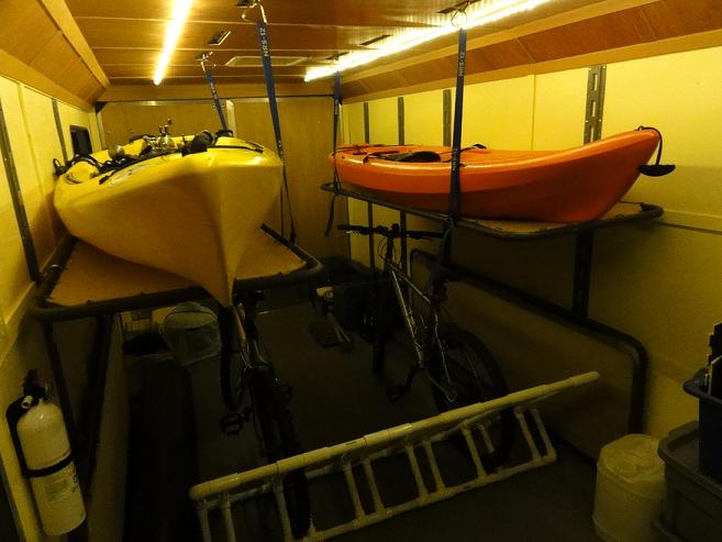

Started with a trailer big enough to haul the 15'-8" canoe if needed. then decided if everyone and everything else would fit. Wanted to keep everything bare bones, functional, and modular.
Found some surplus military cots, used some leftover kayak straps, ordered e-track fittings, insulated roof, walls, and corners, waiting to install the Fantastic Vent (fan) when the weather improves.

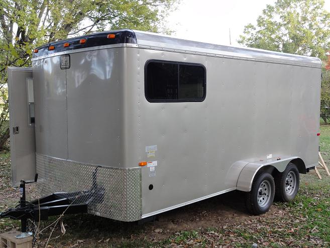

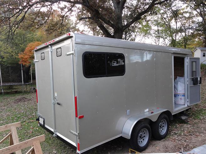

Started with a 7x16 Cargo Craft Expedition.

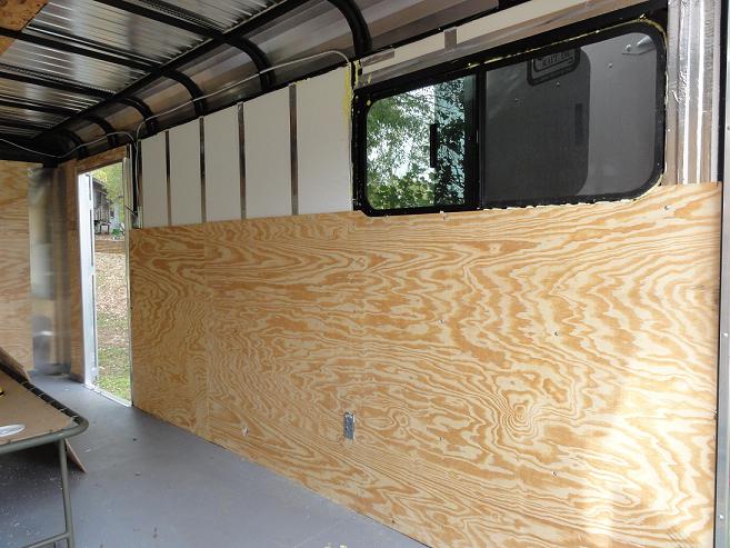

Had the factory install straight axles for extra clearance, RV door, and two windows offset (thanks "Gonefishin").
Added a 15 amp circuit, with a WFCO converter and a few GFCI outlets.
Preferred barn doors over ramp for our use.
Used 1" foam insulation and armorflex wire, (boy am I cheap) taped the seams, off we go.

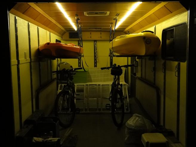

Here's our led rope lights for camera light, can't remember who here donated that idea, but it is great.

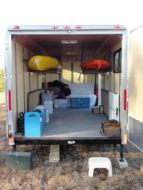

Test loaded the trailer, getting pretty busy in there.
Forgot to mention we used vertical E-track to mount everything, even to help hang the cots from the ceiling.

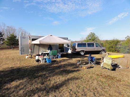

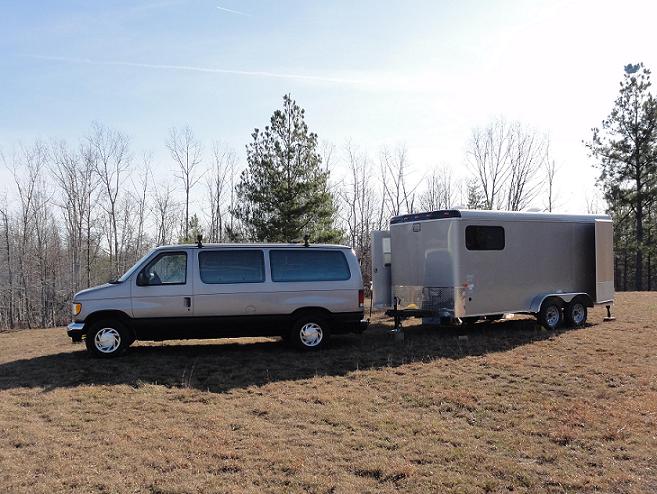

Here we are setting up camp on the first trip.
Our first trip, boondocking, breakfast is served!
Trailer manufacturer had no extra charge for color, of course I tried to match the tow vehicle.
