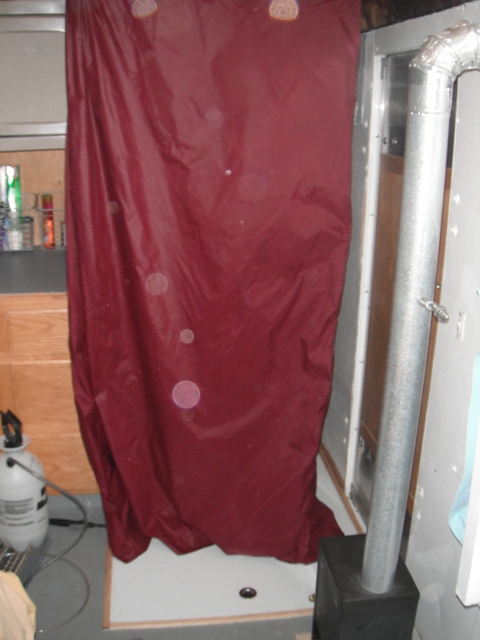

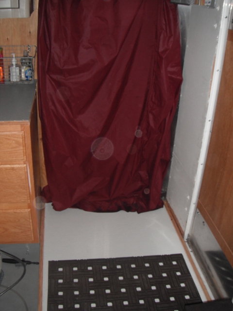

I got a sheet of frp (fiber reinforced panel) and put in a shower floor. I made it fairly simple and extended it from the front to the outside edge of the door. The wood sides are ripped to about 3/8th of an inch. They are put on with tiny screws and lot of silicone caulk. The corners and inside edges are also caulked.
Instead of putting the drain in the middle, I put it in the end toward the back of the trailer. I did that because I almost always level my trailer from side to side but keep the front nose up a bubble. I do that because I sleep better with my head up a little. It also makes it predictable on which way water will run for something like this. :D
The frp bends easily and I intended to recess the drain down about a 1/4 of an inch at a slight slope back to about 4 inches, but I found that the drain I bought doesn't have a strong enough screw system to hold much of anything. Really whimpy!! So until I get a different model it will have to just stay level. The last of the water is still easy to chase out with a squeegee.
Here is the basic floor with the curtain back, but the floor mat still down. (Please excuse the water spots on the camera lens. The camera is a little point and shoot that I use for fishing. It sometimes gets splashed, and I don't realize it. Sorry about that)
And with the shower curtain out. I need to move where my hooks, that the curtain hangs on, are placed so that it is centered and expanded more. That can wait until I get to town to get a few more hooks, as I want to keep the ones on the back wall where I hang it out of the way.

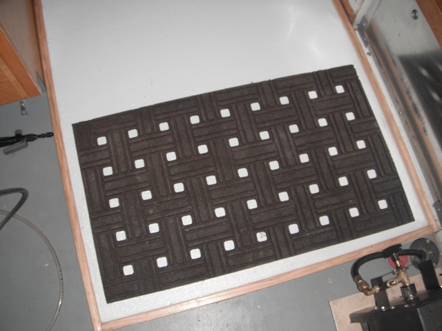

A close up of the mat over the rubber drain plug. Mat isn't straight... I just plopped it down to take the picture. :R
And this is where things sit traveling.
I am really debating on enclosing my bathroom/shower area with my expanding wall on slides. I like the more open feel of just the curtain on the wall. I may just put a folding bench over the porta-potty. The bench would be good for putting waders on and off. Decisions.... decisions..... :thinking:
I really like having the floor and drain in front of the door. I can come in to remove my muddy or wet shoes and contain it all in that area. Then I just use my sprayer hose to wash it out the drain. I do have a bucket under the drain to catch the water, but with the sprayer I only use about a 1/2 gal to at most a gal for a shower.
The bumpy texture of the frp does hold on to some dirt so I either brush it while spraying out or give it a finish wipe with a rag. So far it cleans up pretty nice. :thumbsup: I'll have to see what a couple of years of hard use do to it.

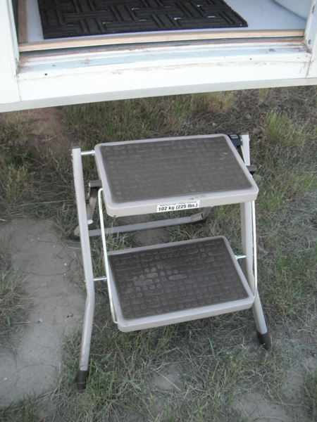

First off: After we did a spring over conversion the camper is much higher and a little harder to get into. I was going to mount some folding rv steps underneath to pull out and I still might later. In the meantime these steps from TJ Maxx have worked out well. The only thing I have reservations about is that the step closest to the ground is a little awkward to hit when you are coming down them. The door closure bar acts as a good handrail also.

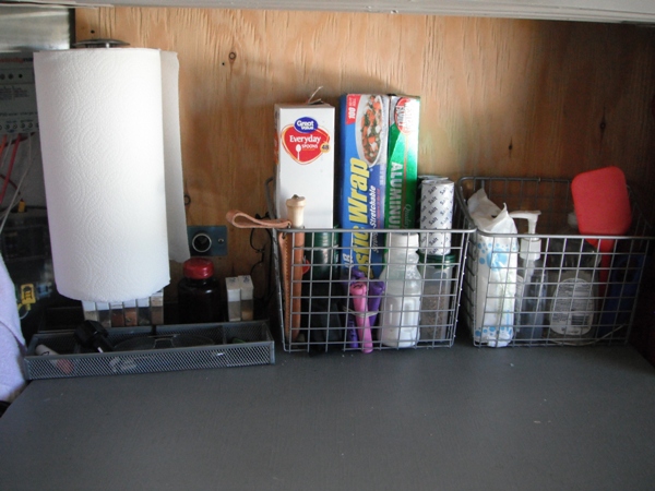

Next: I found some desk and kitchen organizers at a combination of Ikea and Bed Bath and Beyond. A small hook attaches them to the back wall. They ride well on the roughest of roads but are still easy to remove and clean under etc.

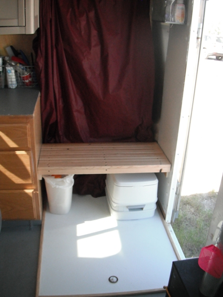

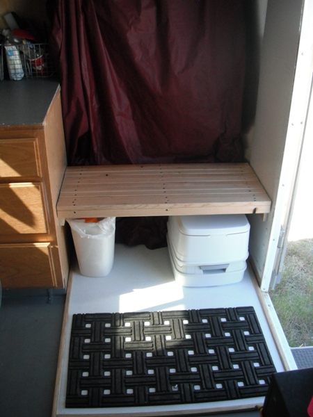

I also need to review some aspects of my shower area. I had planned on enclosing this area but instead I put a bench in.
I did a mockup of enclosing the area, but I like the open feel much better. I also was going to put a panel across the bottom of the bench but decide against it for several reasons. The main one was that I wanted anything that was wet under or behind the bench to dry quickly. I slide my wet wading boots under the bench, hang my waders behind the bench, or the bottom of the shower curtain may be still damp etc.

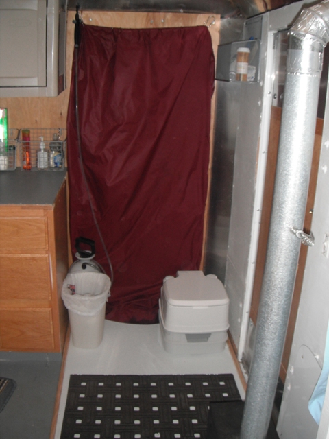

Here is the bench down with the door mat in --- regular day to day use mode:

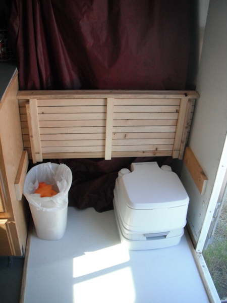

Here is the bench flipped up. Either for access to items under or to provide more shower room.
This is a picture of the bench and full shower floor with drain. Since I have been using this there are a couple of things that I am doing. There have been a few times that I have camped with the camper still hooked up to the truck. When I do that the nose is lower, and I need a second drain at the other end of the pad so I will be adding one.
I have also found that not having the shower floor or pan attached to the trailer floor has some real advantages. Not only can I remove it easily, but when the trailer has a slight slant to one side or the other I can just shim the side of the shower pan slightly, and it drains great with out leveling the trailer perfectly.

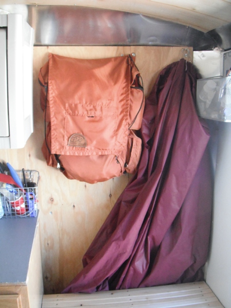

The shower curtain also hides a "multitude of sins" The main one being this very utilitarian antique backpack that holds a bunch of "Stuff". :shock:
It may not be pretty, but it sure is handy! :R

I forgot to mention that I really love the bench! It is great for putting on or taking off muddy wet shoes or waders. All of the water, sand, mud and gunk stays in the shower pan and is easy to sweep up or wash out.
The frp that the shower pan is made of has also held up amazingly well. Rocks, grit, and dirt don't seem to stain or mar it . It cleans up and look nice with just a wipe of a damp paper towel. Awesome stuff!
