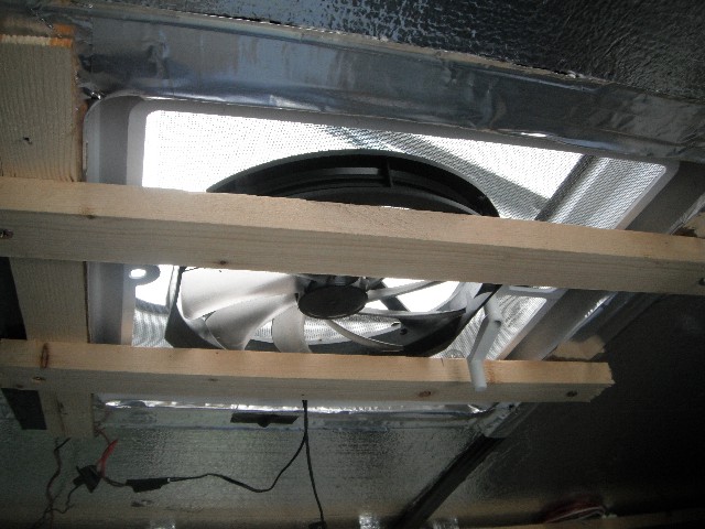

Here is my temporary mount for my computer exhaust fan.
I purchased an Antec Big Boy 200 computer fan. http://www.amazon.com/gp/product/B000V6 ... UTF8&psc=1
I love this fan! I put a single pole single throw on/off switch on it, and it comes with a three speed switch. It is extremely quiet. You can barely hear it on high, but it exhausts the hot air out of the trailer in less than 15 minutes. On low I have to look at it to see if it is on. This is definitely a thumbs up purchase for me. :thumbsup:

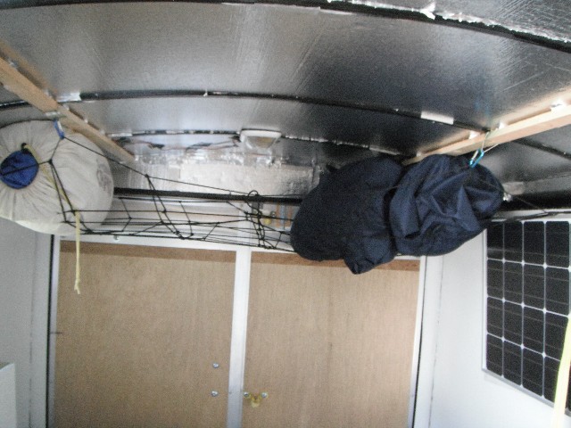

Since I travel on a lot of VERY bumpy dirty roads, anything that is not tied down or leashed is likely to end up on the floor. I got a Harbor Freight cargo net and stretched it across the ceiling. It is stretched with the narrow width across, and I have doubled the length over on itself. Down sleeping bags are best if not continually compressed, so they take up a bit of room in large bags. There are two bags in the cargo net that hold sleeping bags that are loosely packed in, and one bag (king sized pillow case) that holds two pillows. Traveling and storing them up in the cargo net keeps them out of the way, off of the floor, and clean.
As you can see, my ceiling isn't finished yet. It is still just taped in insulation, with 1x2 security to hold it in if it shifts.

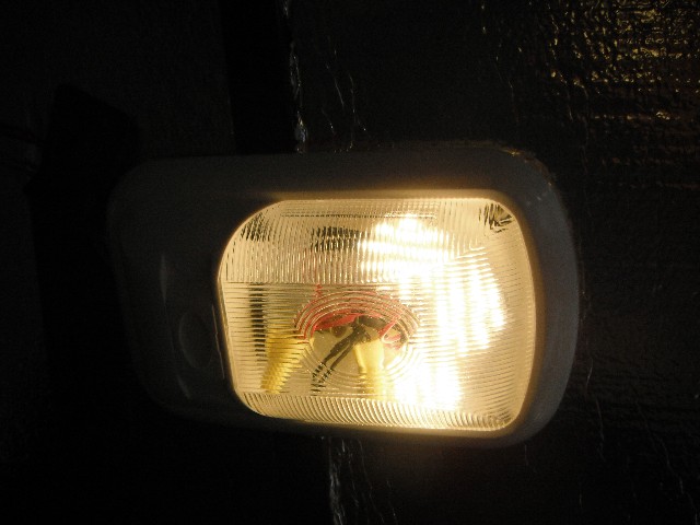

I replaced the incandescent bulbs in my interior lights with warm white leds. Two led pads in the smaller light and three in the larger light. The smaller one is okay, but the light with three pads seems to give off twice as much light. If you look directly at them you can see the wiring in the lights, but it really isn't glaringly noticeable.
The bright white leds would give a few more lumens, but I like the warm white.

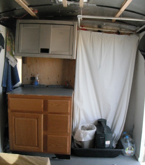

Cabinets:
I used an oak vanity that I cut a set of drawers off of one side and built a new side for it. It is probably a little heavier than I like, but I had it and it is now the size I want. The temporary counter top on it is just 1/2 in plywood painted with the floor paint. I will eventually put a laminate top and trim on it. It has child locks on all the the doors and drawers to keep things closed in transit.
The upper cabinet is a Suncast Utility Wall Cabinet C1500K http://www.amazon.com/gp/product/B0002M ... UTF8&psc=1
It is a little larger than I wanted, but seems to be well built and sturdy. I drilled a hole up through bottom to the handle for a pin (screw) to drop into as a lock for when I am traveling.
Off to the left side is my broom hanger/towel hanger. It is currently holding my cleaning towels, as I was using them. The broom is under the towels. There is also a stash of water bottles along that side. They happened to fit there when I was packing up to go home, and that is where they have stayed. But probably not permanently.
Off on the right side you can see my shower curtain, shower pan, trash can, some extra drinking water, and my Coleman on Demand Water Heater. The shower pan holds it all in place when traveling. I hope to have this area replaced with my shower-cabinet sometime this winter.

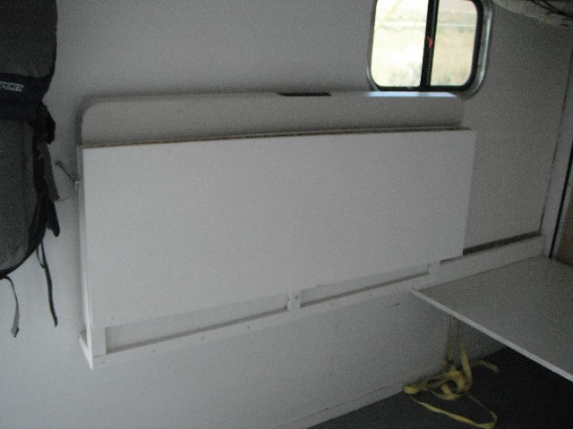

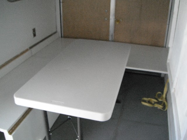

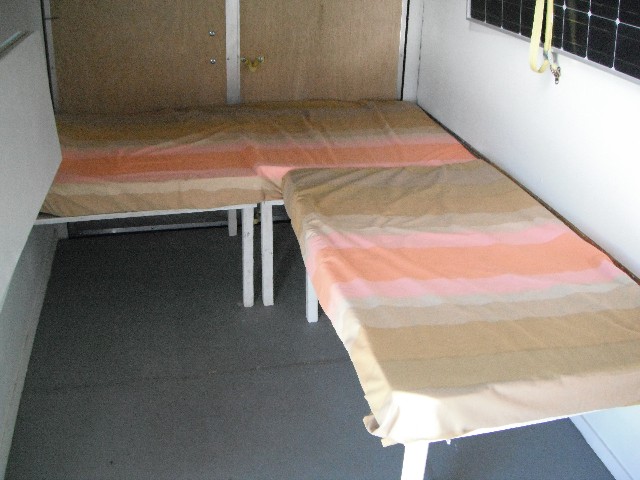

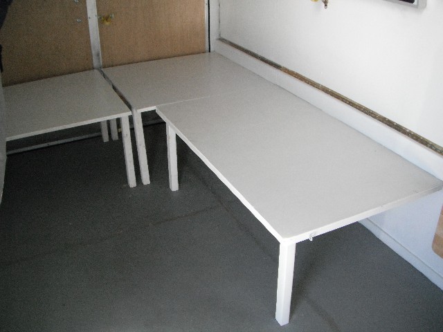

The many moods of my bed!

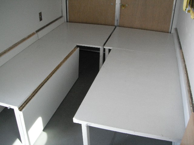

I did my bed in 4-5 sections to allow for versatile arrangement of storage and for how many are camping . Being split allows easy access to the tubs and things I have under the bed. I always have the back two sections down when I camp because I have a bunch of my junk under it. Including a float tube, electric trolling motor, fins, motor mount, waders and so on ... you get the idea. My toys!! -- I have too many toys..... :o
Actually I usually have three sections down, the back two and the right side. That allows me lots of storage, a twin sized bed, and a seat at the Ikea folding table that is on the end there.

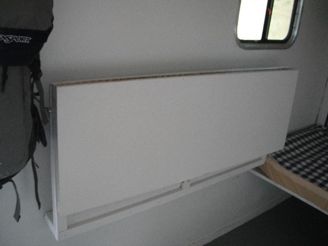

The left front side of the bed is a double fold section. Here it is folded up. There is a hook and eye on the left side. I also usually have a strap on it.
Here with center open:
And with the plus size Queen bed fully out.
I do have the mattress for this cut into sections, but I haven't had a chance to sew the covers for them yet. This is what it looks like with my temporary twin sheet covers.
Here it is with storage strapped in and ready to go. The vinyl blue checked table cloth protects the back section of the bed from any dust infiltration from the back doors. There is very little, but sometime there will be some. So it is easy to shake out, and the table cloth gets used on my outside table also.

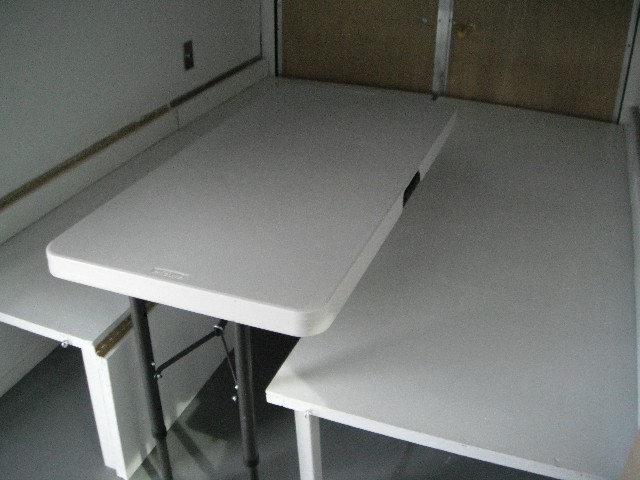

My outside/inside table is a 2 ft by 4 ft light one from Costco. It is adjustable in height and very handy both camping and in the house when lots of grand kids come at once.
It rides stored in the left side fold up section.
There are lots of ways to use the table inside also.
With more room in the front.
With the left side down
And if I have lots of grandkids with etc
It is harder to get into this one, but with the table out a bit your legs swing in easily.
When it is just me, I use the Ikea fold down table, and only use the other one outside if I need it for cooking etc.
I have a lot to do yet, but it is comfortable for me to camp in as it is until I get to the details. A little color in curtains and cushions etc will be nice to look forward to.

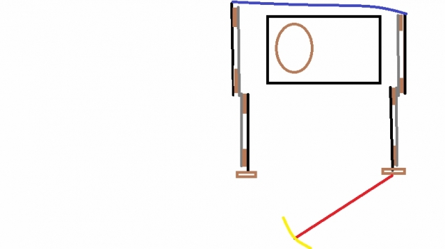

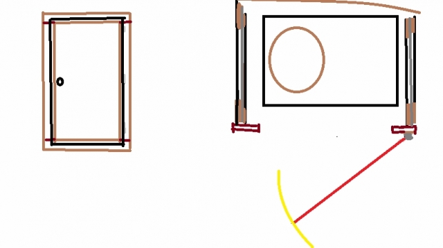

Here are two quick Paint sketches of my expanding bathroom idea. Hope it helps.

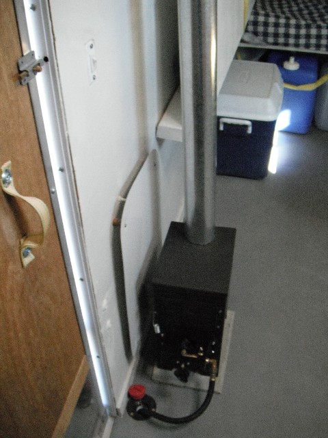

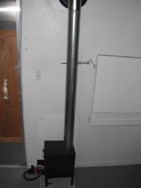

It's getting colder, and it was time I addressed the heat issue.
I would have loved to install a Dickinson Marine 9000 propane heater (http://dickinsonmarine.com/propane.php) as BC Dave and GoneFishin have done, but it just wasn't to be right now. I can't use electric because I boondock camp 100% of the time. I needed a VENTED propane heater or furnace as I can't use the catalytic and Mr Heater types. The propane furnaces are nice and I almost got one, but they need a lot of permanent room for installation, would be hard to remove for using the CT to haul things, and they take a lot of power to run the fan. I finally decided to give the Nu-Way Model 2000 Propane stove a try. http://www.nuwaystove.com/model2000.php
It is light at 10lbs. Relatively small at 9 X 7 X 15. And low enough priced that I was willing to try it without seeing it in person. If I didn't like it or found that it wouldn't work for me I could easily sell. I am happy to say that it works great!
I currently have it set up as completely removable. I will probably mount it in place in the near future. Mounting it in place will involve about 2 screws for the stove and a couple for a pipe support. I will continue to use the deck plate cover and keep the outside pipe vent removable. I travel on very dusty roads and like to keep my CT as sealed as possible.
I placed it by the side door and protected the wall with an aluminum shield.

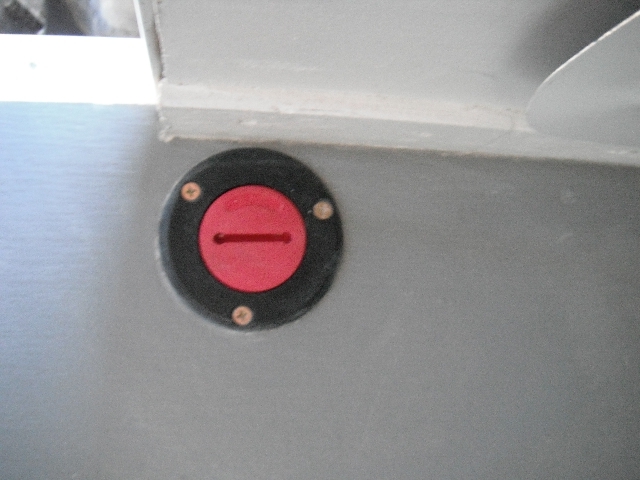

For now the propane hose comes in a small deck plate on the floor. The same deck plate can be used for an AC extension cord also when I am at home.
It uses a 3 inch vent pipe with a 3" cast iron damper. The damper really improves the heat retention in the lower pipe.
The stove is listed at 12,000 BTUs, and it can really put out the heat quickly. I don't need nearly that much. The flame is completely adjustable from high to very low. Here is a picture of the flame when the control is about medium.
And at low. Sorry this picture is blurry.
Here is a shot of the exterior vent in place.
And with the vent removed.
And the floor deck plate closed
I do have a carbon monoxide detector, but haven't had any issues so far. Before I installed it we set up the stove and the pipe in our garage and ran it on high for quite awhile to burn off fumes etc.
So far I have used it for two nights at about 20 degrees. I ran it on low with the roof vent open, and it kept the CT at a very comfortable temperature. I have also used it a couple of times with an adapter, regulator, and a 1lb propane bottle. It worked well, but did ice up the bottle after a while.

I find interesting the way folks handle the challenges. Which brings up my question. Would you not be ahead by asking that interior plywood not be attached just loaded in or left off entirely? A) you would see the bones, B) you would not have to deal with screwball fasteners, C) they would have to do the job of paint etc, of the ribs.

Re: 2013 Mirage XPO 6x12- Mt Air Express
Postby tnriverluver » Thu Oct 24, 2013 6:33 pm
You are probably going to be a little too warm. I can heat my 7X14 with a small 1500 watt ceramic heater on low and it will keep it a toasty 75 degrees when in the upper 20's outside. Never even have to turn it on high unless I need to warm it up quickly.
tnriverluver
Posts: 161
Joined: Mon Sep 24, 2012 6:16 pm
Postby hankaye » Thu Oct 24, 2013 8:30 pm
Rainier70, Howdy;
Looks like you could even perc. a pot of coffee on the flat top of the stove. :thumbsup:
How did you insulate the hole for the chimney? As short length of tri-wall for the thimble?
3" is what is used for Gas fired hot water heaters isn't it... should be plenty of parts available
for building a chimney... :thinking:
