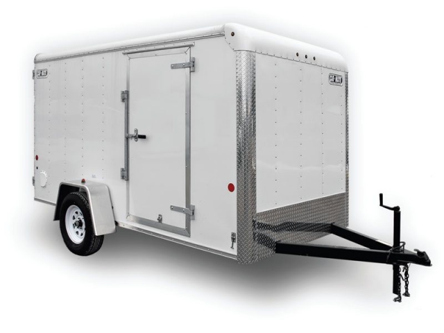

After looking at trailers and following this great forum for about 18 months now, I finally ordered my CT yesterday. I will use this posting to document describe the trailer and my plans, but I will create another one or modify the title for this one as time goes on to share the build process.
After reading all the great posts from others on their trailers, after researching many brands and then taking into consideration a lot of other issues, I went with a Car-Mate 6 x 14 Custom Cargo. I added an extra 6" to the height for a total interior height of 6', 6". Here in Virginia, I seemed to have a small selection of brands to go look at. I will not compare the quality of mine to other forum member choices as that is just not a good thing to do. Everyone makes their decisions based on what they see and what is important to them. I just looked at what I could, read and absorbed what others wrote about their CT's, talked or emailed with dealers and manufacturers, worked the calculator, reviewed what my goals and needs are and then went from there.
Here is a photo of a similar model, although I do not think this one looks 14 feet long. And I selected a silver color over white. I wanted to stay light in color as I was sensitive to the heat absorption issues, but I wanted something different then white. Also matching my TV's color was important to me. I guess time will tell if I made a good decision. But one thing in my favor is that since I mostly will camp in the eastern states, I will not have the same issues as you western campers have when it comes to both high temps and large temp swings in the same 24 hours.
It will have a 6000 lb Dexter Torsion axle rated at 5000 lbs by the builder. Electric brakes are self adjust and it will have EZ lube. Tires will be 225's.
I ordered two ceiling vent framing for my adding vents myself later. I ordered an 32" RV door and specified the threshold be 1 1/2 inches higher then normal so I can add insulation to the inside floor with sleepers and then 3/4 (or maybe less) plywood top flooring. I think this will give me a good insulation benefit. CM will raise the door and leave the threshold strip loose in the trailer.
I wanted screwless siding, but had to give this up if I wanted to easily be able to do my own insulation of the sides. The reason is interesting. CM builds their trailers using either wood or steel uprights (steel is the higher priced option). I am taking a lead from Jerry from OTTCT and his successes with wood. Their mounting of the interior paneling is done with glue and staples. The fit was precise on the model I looked at. For me to take the plywood off so as to be able to add insulation and windows would have been very difficult and would destroy the plywood. If I wanted screws used, I had to go to steel uprights and that would have added about $400 to the cost. Decisions, decisions and then optional ways to do something; very frustrating.
But I could go with the plywood on the outside with screwed aluminum exterior paneling and the trailer would come to me ready to be insulated on the inside (means nothing added to the walls by CM).

I am having a hard time trying to decide if I want to add 2" to my ground clearance. I can do this by having the Torsion Axle moved from the neutral position to. 22.5 degree down angle for the torsion arm. There may be an additional charge for this change.
Right now the platform height is 19". Subtracting 4" for the frame tubing and 3/4" for the plywood floor that leaves a calculated clearance for the frame of 14 1/4". An added 2" results in a 16 1/4" clearance.
What have others done? I will not be going off road but will go on Forest Service gravel roads and sometimes setting up in primitive sites. Also I will add plumbing someday for the shower to the under carriage.
I must advise the dealer on my decision tomorrow morning. My inclination right now is to leave things alone and not add the change to my order.
Bob

Re: From Virginia - Finally ordered my CT
Postby OverTheTopCargoTrailer » Thu Aug 14, 2014 7:10 pm
Bob
I had hard time getting them to change that to -22.5 deg , it's still pretty high as it is.
The factory dexter does not charge extra just CM makes new drawings for you to approve
With me they really did not wanna change.
Posts: 1628
Postby lrrowe » Thu Aug 14, 2014 7:46 pm
I am not sure from your note. Did you get 22.5?
If yes, what was the actual clearance for you when done? Is it possible to measure yours?
And yes, this will all go towards a drawing for me to approve.
Bob
lrrowe
Posts: 3285
Images: 439
Location: SW Virigina
Postby OverTheTopCargoTrailer » Thu Aug 14, 2014 9:32 pm
Hi bob
No I did not get -22.5 I got the standard I think + 15 or +22.5
And they did want maybe $250 extra for -22.5 when it's Free from Dexter
I asked them about it & that I know it did not cost more -
I think they want more money for the drawing & special order / handling ..... Hassle & stocking etc
I would guess it will increase you build time to 8 weeks also, mine was done in 3 weeks
If you get the 5,000 axel - your finished weight should be 3,500 - 4,000 to get the best ride
But even empty my towes like a ghost.
My current clearance fully loaded is 12"
Cheers OTTCT
Posts: 1628
Postby lrrowe » Fri Aug 15, 2014 2:29 pm
Thanks Jerry,
I went with it....22.5 degree (do not know whether to say + or - position) to give me two more inches of ground clearance to the frame. With some travels and parking off road and with the very likely possibility that I will run some drain pipes (even if only for the shower), I pulled the trigger on this question.
Bob
