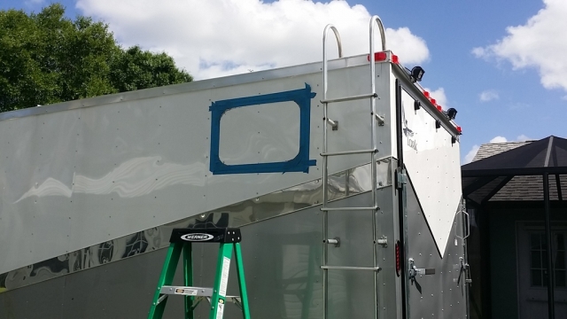

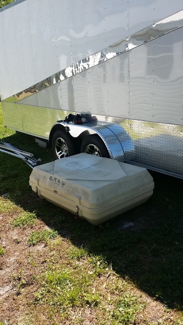

Postby flboy » Sat Apr 09, 2016 11:09 am

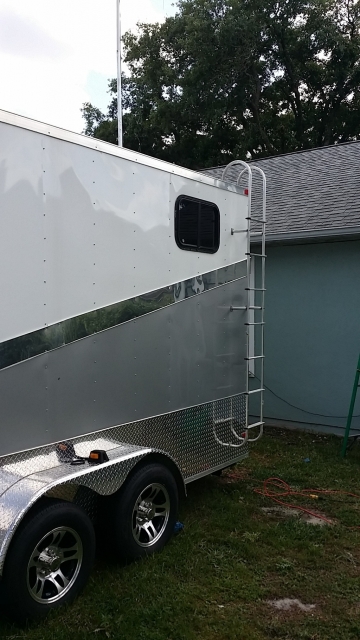

Decided to go with the ladder and the 20 cu ft. cargo carrier I also recovered from the donor RV. It needs to be cleaned up... but will be perfect for the grill, chairs, etc. so I do not have to fill up the truck bed. I also have some aluminum channel I recovered from the awning to make the roof rack for this out of. :thumbsup:

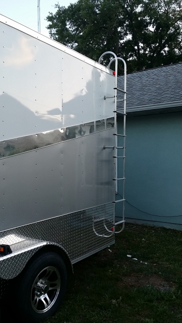

Postby flboy » Sat Apr 09, 2016 7:09 pm
Well, the ladder is installed. I weigh about 195lbs all dressed and the ladder is rock solid climbing up. I had to build some support into the walls and ceiling for where it missed beams. This is the time to do it now, before I button up the inside.

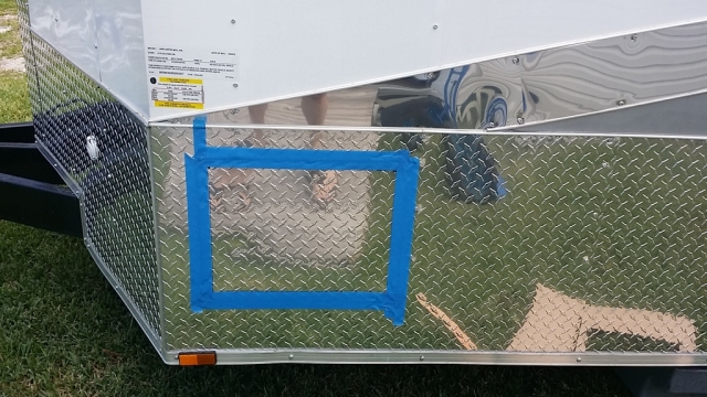

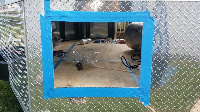

Postby flboy » Sun Apr 10, 2016 4:35 pm

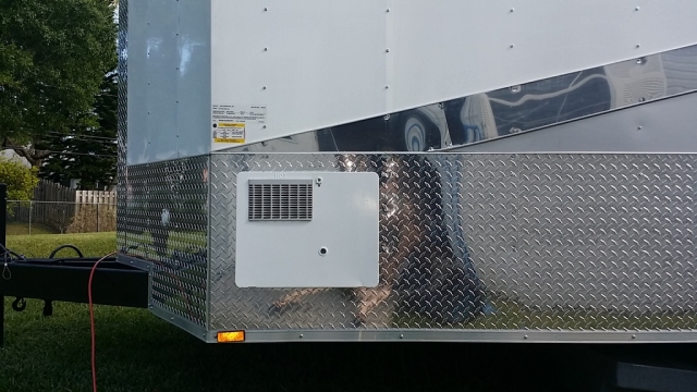

I keep chipping away at it. I got the hole cut and the Hot water heater setting in the hole. I have some bracing yet to do inside and then I have to seal it all up, but I think it looks good. Definitely a "measure twice, cut once" event.
I used a 4.5 In angle grinder to cut the beam in the wall and a jigsaw for the hole itself. It cut real easy. I'll take a few pics of the bracing when I get to it later in the week. :)

Nice job on the water heater! Looks like it was installed at the factory that way.

aggie79 wrote:Nice job on the water heater! Looks like it was installed at the factory that way.
Thanks! That's the look I am going for. I hate cutting holes in the roof and sides... always makes me nervous.

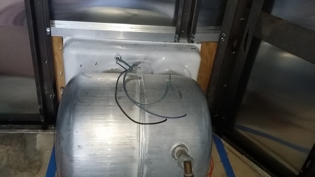

Hot Water Tank Mounted
Postby flboy » Thu Apr 14, 2016 6:40 pm
I got the bracing in on the Hot water tank and it is all screwed in. I was going to weld in the braces, but I have found you can take a 1" square aluminum bar and it fills in and then I can drill it into the parts of the P-hat bracing that extend over it. It seems to be just as strong and is much easier. I am probably going to do the same for the windows. I have taken Marine plywood and Liquid nailed on the sides so screws can drive into something and the top and bottom go into the aluminum bar. Very sturdy.
I will build a Styrofoam enclosure around the tank now for insulation and blow in the expanding foam to fill in the gaps. It should be well insulated.
