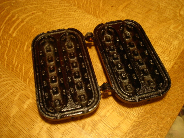

Gus....I'd double think the hinge at the end of the iron. That makes the entire thing really long to fit on a stove, whereas on the side you can pre-heat both sides on 1 burner and the entire thing won't be 2x as long when opened. Without handles, right now it's 14" if hinged on the ends. Batter can also easily be poured into both sides and it can be closed up quicker with less run out issues. I have a cast iron one that was custom made from a mold taken off an original. It was just a quick knock off he only ran 5 of them, took some time with a die grinder to clean it up, but it does cook really well and holds the heat better than the aluminum. Way heavy however! Shown without handles.
Doug

Postby eamarquardt » Sun Dec 29, 2013 2:13 pm
doug hodder wrote:Gus....I'd double think the hinge at the end of the iron.....................................
Here are my thoughts:
All waffle irons have the hinges at the opposite end of the iron from the handles.
All of the Pie Iron products have the hinges opposite the handles. http://www.pieiron.com/designs.htm
No matter where the hinges are, if you pour batter in both halves yer gonna have to be a bit creative in closing the iron while not spilling the batter out. Maybe a little bit more awkward with the hinges at the end but I don't think it's a that major a deal.
I've watched the videos of youse guys using the original waffle dog irons and seen the efforts, such as using vice grips, to keep the irons closed while in use. I think having the hinges opposite the handles would help a lot.
It does make the assembly twice as long when open but the closed length of the waffle iron would remain the same. I think the improvement in keeping the iron closed during use would be worth dealing with the additional length when open.
I agree being able to heat both sides at the same time is a plus but the waffle dog iron is the only item of this type that has that feature. You can't do that with the PieIron products or waffle irons (unless you take the waffle iron apart and heat the halves on two separate burners.
I'll poke around a bit more this week. Getting the castings ($50 a set) isn't a big deal. Then you have to add the handles,drill out the hinges, and rivet the halves together. I think having jigs would make doing a lot easier and ensure the job is done right but I don't have the energy to make em right now.

Postby doug hodder » Sun Dec 29, 2013 4:42 pm
Dean used vice grips as he way overstuffed the iron with too many ingredients. Others have had no keeping it closed issues.

Postby Kevin A » Sun Dec 29, 2013 5:32 pm
Rather than change a design that works, wouldn't it be easier to simply drill and tap new holes for the handles that are located opposite of the existing hinges? Just a thought...

Postby eamarquardt » Sun Dec 29, 2013 7:28 pm
Kevin A wrote:Rather than change a design that works, wouldn't it be easier to simply drill and tap new holes for the handles that are located opposite of the existing hinges? Just a thought...
I was unaware for the reason clamps were being used due to "overload" as "all I know is what I read in the newspaper" and see on YouTube. Moving the handles to opposite the hinges would, though, give you a better mechanical advantage to hold the two halves together during "overloads".
As far as moving the handles goes: Excellent suggestion! That's certainly a viable option that would accomplish the same thing as moving the hinge opposite the existing handles. One might have to add some bosses for the extra meat needed to drill and tap for the handles but adding bosses to the pattern would be easy enough. Actually you could leave the current bosses there, add new bosses that are also drilled and tapped and then you would have the option of using the iron either way. A win/win!
